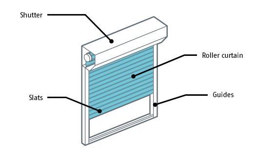

Greetings Sir, I have a motorized RTS roller shutter (which can be controlled by both hand held remote controller Or wall switch) . The thing is when the motor detects an object, it will put its entire weight on the object and then stop (which means it will suffocate that "object"). Hence we can say that the system has an obstacle detection but its not Child Safe. The main problem is that kids play with the remote controller and below shelf shutter. Please can you suggest a solution to make it completely child safe. Thank You
I discussed this with a supplier, he suggested me to code the switch. by doing so only the person with password can operate the roller shutter.
So I want to code/ enable password to the switch and when I put the password the switch should function ON/OFF. I should be able to function it with my I-phone i.e. away from home.
What's a roller shutter?
EDIT -- Like this? How big?
https://www.somfy.be/common/img/library//VR_graphique_anime_EN.gif
