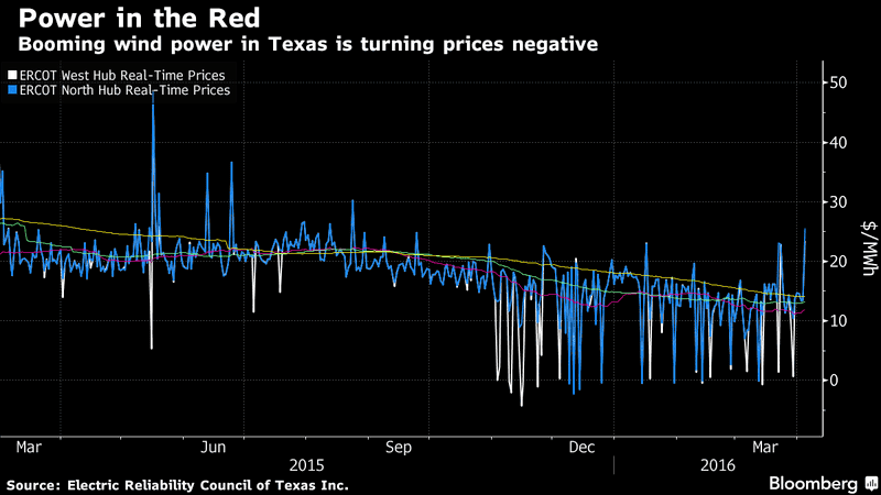

mheslep said:
LCOE is a cost to deploy caculation. An investor needs to know both cost *and* return on investment. For wind generation, after reaching 10% of load or so, as in Texas, the answer to the investor is increasingly, 'zero, or maybe you must pay people to take your wind power'. The reason investors continue to invest is that the government pays them $23 per MWh, for now, which covers the losses.
That negative pricing, may be their own fault.
The Night They Drove the Price of Electricity Down
First, Texas is an electricity island. The state often behaves as if it is its own sovereign nation, and indeed it was an independent republic for nearly 10 years. Alone among the 48 continental states, Texas runs an electricity grid that does not connect with those that serve other states. The grid is run by Electric Reliability Council of Texas, or ERCOT.

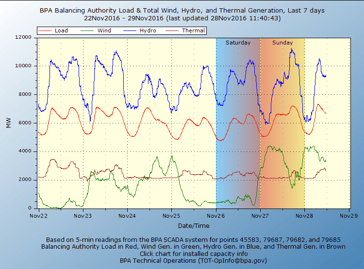

I'm still fascinated by the BPA live graphs.
It looks as though the wind farms nearly supplied BPA's domestic load requirements, at a few points.
The flat nature of the "thermal" producers is also interesting.
