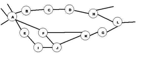

Those principles apply equally to networks with 2 nodes as to networks with 200,000 nodes. If you memorize those two, you are 99% of the way home to understanding the entire power grid.
Now we can generalize.  A power grid is a network made up of nodes like A and B, branches that connect the nodes, sources (generators), and sinks (loads).   We analyzed just one branch above, but we can repeat that for any branch in an arbitrarily large network.  So, no matter how large the network, you only need to know how to analyze one branch at a time.   Utility planners use software to routinely analyze networks with 250,000 or more nodes
power node.

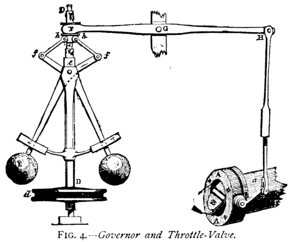

Now, consider this line of logic for a generator at node A.
  1. The phase angle ##\theta## between two node voltages is proportional to the time integral of the frequency difference between those nodes, and the power flow between those nodes is proportional to ##\theta##.
  2. The frequency of a generator is directly proportional to its speed in RPM.
  3. More speed, more kinetic energy. So on an incremental linearized basis, speed is proportional to the integral of the net power on the shaft.  Net being the sum of mechanical power in, minus friction losses, minus electrical power out.
To achieve a steady-state, the rate of change of speed and the rate of change of angle must both be zero. That means that the electrical speed (i.e. RPM/N, where N=number of pole pairs) of every generator on the grid must be identical. (We, therefore, call it a synchronous grid.)  In a non-steady transient state, we integrate power mismatch once to get frequency, then integrate frequency to get the angle, then feed power as a function of the angle it back with a minus sign.  That is a description of a classical second-order harmonic oscillator.  Indeed, generators on power grids typically perform like lightly damped oscillators.
The good news is that every generation can measure the local frequency. It is directly
proportional to RPM. That suggests a very simple and completely distributed way to regulate power on the whole grid.  We simply apply James Watt’s 1788 invention, the flyball governor, to each generator.  It varies mechanical power in response to speed changes.   Then we tune the gain of these governors, to be the same in percent, for every generator.  Thereafter, if we add load to the grid, the frequency will start to drop. The speed governors will open the throttles to make more power, with each generator inherently taking up its proportional share of the load until mechanical power (less losses) and electrical power are exactly balanced once again.
I think it’s very cool.  Using centuries-old technology, we can achieve an exquisitely sensitive dynamic balance between total generation produced (minus losses) and total load consumed, all distributed over an arbitrarily large geographic area.  In the same stroke, we have satisfied grid requirements #2 and #3. Hats off to the engineers of yesteryear.
We stopped using flyballs in the 70s.  A modern electronic implementation of a speed governor can be done with a single operational amplifier.  It could hardly be simpler.   This robust distributed scheme kept all the US’ grids operating without a single regional blackout from about 1889 until November 9, 1965 (the date of The Great Northeast Blackout).  Even today despite all our computers, the speed governor is the primary regulator of power grids.  It is inherently distributed. It does not need remote communications of any kind. It is not digital.  It is very difficult to attack via remote means.
