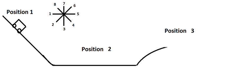

This was a question on my test. I had to choose the direction of the acceleration vector for each position. I was wondering if I chose the correct answers.
a = gsinθ
Ʃ[itex]F_{y}[/itex] = [itex]N_{1S}[/itex]( normal force) - [itex]W_{1E}[/itex] ( weight force)
for position one I picked 4
for position two I picked none (there was an option for that)
for position three i picked 3
Yup, I agree with Villyer, they appear right to me as well. :-)
