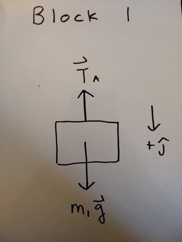

FBD Block 1
Free-body diagram labelled Block 1 showing upward tension T_A and downward weight m1 g on a block, with a downward-pointing +j unit vector beside it.

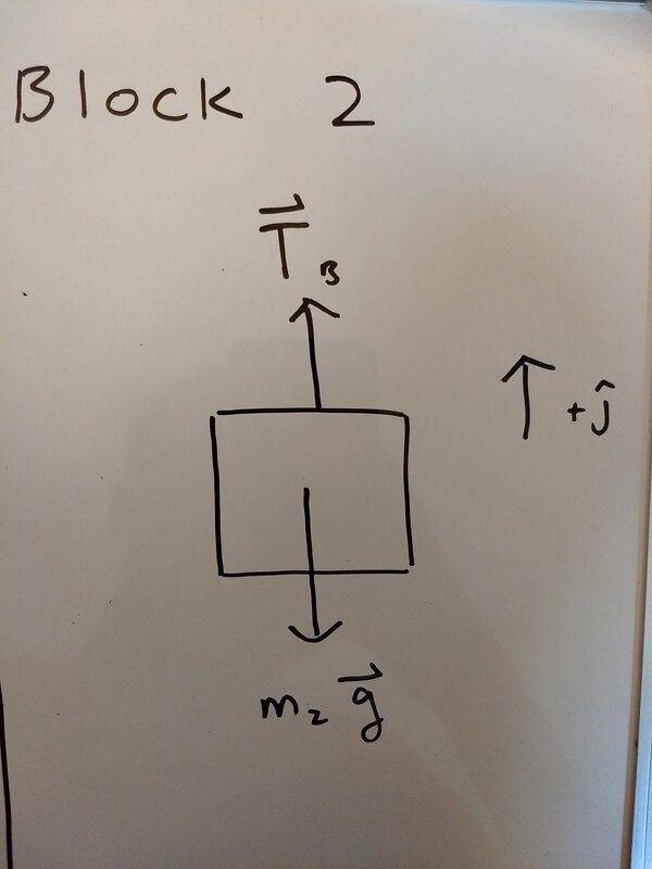

FBD Block 2
Hand-drawn free-body diagram labelled Block 2, showing a square block with an upward tension arrow T subscript B, a downward arrow labelled m2 g, and a separate upward unit vector +j arrow.

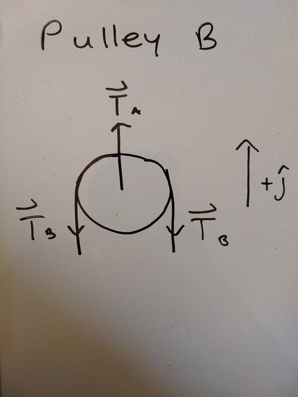

FBD Pulley B
Handwritten free-body diagram titled Pulley B: a circle with tension T_A pointing up from its top, tensions T_B pointing down on both sides, and a +j unit vector arrow pointing up on the right.
I'm mainly concerned with the coordinate system direction in this problem, but just to show my attempt, here are the equations I got from the system.

You can choose the positive directions as you have chosen them. (Personally, I find the signs to be easier to handle in this problem if I follow the suggestion of the question and take positive direction to be the same for both blocks.)
##-T_A + m_1g = m_1a_1##
##T_B - m_2g = m_2a_2##
##T_A - 2T_B = 0##
These look good for your sign conventions.

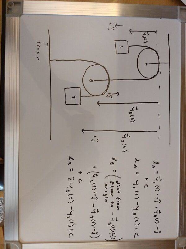

I believe there is an error in these equations. Are the positions ##y_1(t), y_2(t)## and ##y_B(t)## all measured from the same origin? Is ##y_B(t)## in the equation for ##l_A## the same quantity as ##y_B(t)## in the equation for ##l_B##?
Suppose block 1 accelerates downwards. So, for your sign conventions, ##a_1 > 0 ##. Your equation ##a_1 = -a_B## then implies that ##a_B <0##. Then, your equation ##a_B = \frac {a_2}{2}## would imply that ##a_2 <0##. For your sign convention for block 2, this would imply that block 2 accelerates downwards. So, your equations imply that if block 1 accelerates downwards, then block 2 also accelerates downwards.

I think you're right. I chose positions ##y_1(t), y_B(t), and y_2(t)## all from the top of pulley A, so I went back and made it consistent with the sign convention which got me the following:
##l_A = y_1(t) - y_B(t) + constants##
##l_A'' = a_1 - a_B = 0##
##a_1 = a_B##
##l_B = (distance from origin to floor - -y_B(t)) + constants + (-y_2(t) - -y_B(t))##
##l_B = 2y_B(t) - y_2(t) = 0##
##l_B'' = 2a_B - a_2 = 0##
##a_2 = 2a_B##
This seems to hold with the scenario of ##a_1 > 0##, because ##a_B > 0## and ##a_2 > 0##, which, by the sign conventions I chose would mean ##a_1## accelerates down and ##a_B## and ##a_2## accelerate upwards.
This gave me ##a_2 = \frac {g(2m_1 - 4m_2)} {4m_2 + m_1}##, which held up with the test you suggested!

OK. I'm still not sure I understand how you are defining ##y_1(t), y_2(t)## and ##y_B(t)##. It would be helpful to indicate these in a diagram and also to specify the positive direction for each of these. But, anyway, your answer for ##a_2## looks correct.

Ahh, sorry about the confusion. I attached a diagram below of how I had defined ##y_1(t), y_B(t),## and ##y_2(t)## using the sign convention I originally did for reference of any viewers. Glad to here that the answer checks out though!
