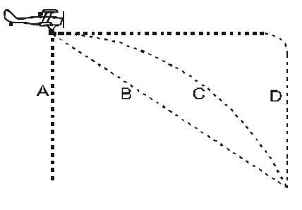

I-The aircraft in the figure is flying at a constant
horizontal speed. Suddenly a wheel comes off the
landing gear. Which one of the four paths describes
that of the falling wheel as seen by an observer on the
ground?

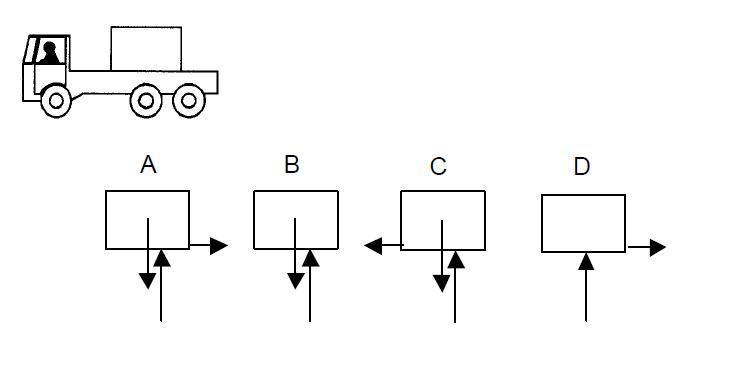

II-A heavy crate rests on the bed of a lorry, as shown in the figure. The lorry
begins to move forwards, but the friction prevents the crate from sliding
on the bed. Which one of the four diagrams below best describes the
forces acting on the crate during the acceleration?

I think that:
I-C
II-C
