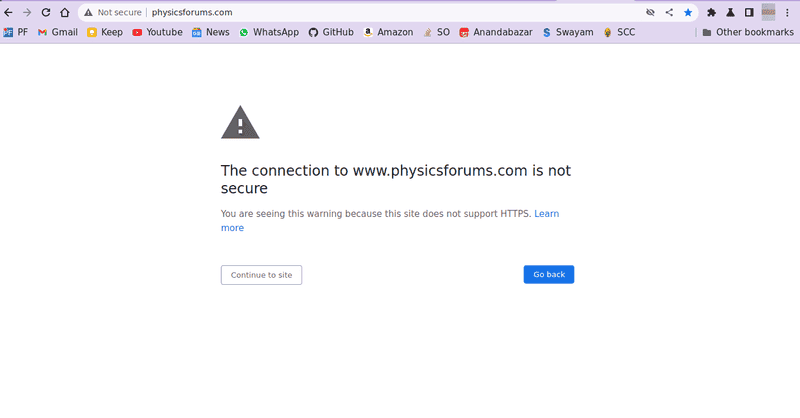

There are some weird things happening with my browser. These started quite some months back; don't remember exactly when.
First and foremost, whenever I want to visit PF, I get this screen:
Next, and the more irritating issue: Regardless of which website I intend to visit, Chrome will often bring me to PF instead. I click on the link for Stack Overflow, and PF opens up. I want to go to GitHub, again PF comes up. I am searching something, and as soon as I press Enter, the search is not executed, and instead, PF opens up. If I type "w" on the address bar, Wordle comes up as a suggestion. I press Enter, and land in PF. I click on the bookmark to my college website, and guess what! It's PF, again.
I have already tried clearing my browser cache, but the issue continues. It's erratic. Sometimes it keeps on happening two or three times before resolving temporarily.
I am posting this here because I believe these issues are with my browser rather than PF.
Any idea how this can be resolved? I like visiting PF, but every time PF popping up seems a bit irritating.

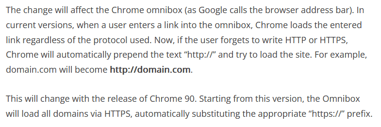

The answer is possibly in your screenshot.
Chrome doesn't trust links to sites that are just http://example.com
It prefers links to https://example.com
So either you have a bookmark without the S that you are using, or you are typing it and your previous attempts without the S are being pushed as the nearest to what you want, you click on the suggestion, and then it is being rejected. Type the correct full url like this
https://www.physicsforums.com/threads/chrome-has-a-strange-affinity-to-pf.1045104/
After a while it will have learned that name proerly and suggest the https version first.
Or its a DNS thing, as suggested earlier.
You can use the manage bookmarks to check what urls are used. There should also be a way to clear any history so that the "complete the bad url" behavior won't happen.
I don't think this is the problem. The site automatically redirects visitors to the secure URL.

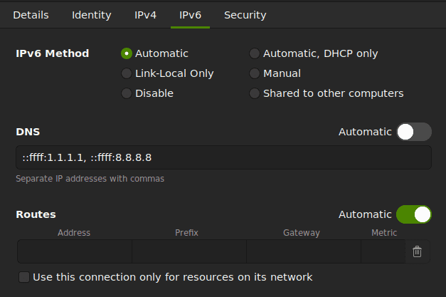

A few questions/thoughts:
  • Why are you running a local DNS?
  • Is it configured properly?
  • How do you know it is configured properly?
  • Are you using a dodgy internet connection where you share a router with other subscribers?
  • Can you change the router's DNS server to 1.1.1.1 (Cloudflare) or 8.8.8.8 (Google)?
  • Can you reinstall a clean OS (already suggested in another thread), and browsers with no plugins to make sure there is nothing there that shouldn't be?
Good catch. The bookmark was just www.physicsforums.com; I modified it by adding https://. The "Less secure site" in Chrome and "Connection timed out" in Firefox seems to have gone for now, and PF loads faster.
Unfortunately, no. The router is not a TP-Link router and was supplied by the ISP. I checked their options and there is no option to change the DNS. The DNS is, in fact, configured as follows:
I have, however, changed the DNS settings in my OS as follows:

Greg Bernhardt said:
You can download as an app too https://1.1.1.1/
Didn't know about this, thanks for the information. Installed and running on my laptop as well as Android devices.
One thing I wanted to point out: in post #25, I had said this:
Wrichik Basu said:
PF loads faster
This is mostly not true. Although initially, it seemed to load faster, currently reaching PF takes more time compared to Stack Overflow, GitHub, and others. But the "less secure site" screens are no longer there.
