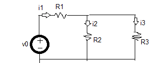

Can someone please tell me if i am setting up the KVL and KCL for the following circuit correctly?
KVL: v0 = i1*R1 + i2*R2
v2 = v3 // v2 = i2*R2; v3 = i3*R3
KCL: i1 = i2 + i3
thanks in advance
Looks fine, if I'm understanding your notation correctly.
