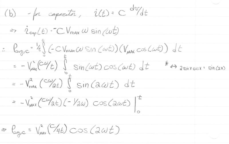

Let [itex]v(t) = V_{max}\cos(\omega t )[/itex] be applied to (a) a pure resistor, (b) a pure capacitor (with zero initial capacitor voltage) and (c) a pure inductor (with zero initial inductor voltage). Find the average power absorbed by each element.

For the capacitor and inductor I am assuming I will go through a similar procedure, however, my textbook makes a claim in the chapter that I disagree with. It says that the average power of a capacitor and inductor whose voltage and current vary sinusoidally can be shown to be zero. Is this ALWAYS true? Or only when the time interval of interest is some multiple of the period?
Carrying out the procedure for a capacitor, I have the following:
It seems to me that this is only zero when the t = t0 + nT where T is the period of sin(2wt) and n = 1,2,3 ...
Any thoughts? Is this correct that the average power is only zero over multiples of T or am I missing something?
Thanks!
The text statement is incorrect.
The power certainly varies over time, which is why the exercise in finding average power is useful in the first place.
The instantaneous power is P(t)=i(t)v(t). For sinusoidal voltage it's evident that the power is not constant.
In order that the integral be invariant over any interval the integrand must be constant.
