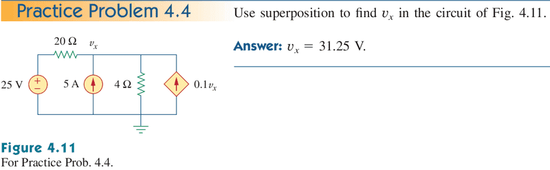

I've been trying to to solve this for hours now and I am frustrated. I think I have vx', which might be wrong, but I cannot find vx" for the life of me. I have posted all my work, I know what I have down so far is correct, but I am missing something to move forward.
Using Superposition, find vx in the circuit figure.
vx= vx' + vx"
Mesh Analysis (KVL), Node Analysis (KCL), Ohm's Law
I cannot find vx"! I need i3, but I literally can't find anything in the second circuit. Please help!
http://i61.tinypic.com/2zflrbc.jpg
Maybe you want to redo your calculation for your nodal analysis at point Vx
Your equation should be 5 = i1 + i3 + i4 (since i2 = i3 + i4), but I see 4 terms in your equation, which should only be 3 terms?
Unless it is stipulated that you must use mesh or nodal analysis, why don't you do it the easiest way you can see? Then once you can get it right that way, try it afresh using the more formal approach.
The dependent source is active with either source, whether you're considering the 25V source or the 5A source.
