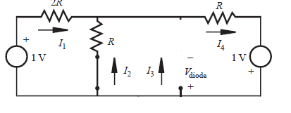

The circuit of interest is attached.
The question is to solve for I1, I2, I3, I4, and V_diode.
My question is will the variables come out to be numbers or dependent on R?This is how I did it and it depends on R:
I3=0 b/c of the open.
The branch with the open is pretty much not there.
Thus,
KCL: I1+I2=I4
KVL gives 2 equations:
1-2R*I1+R*I2=0
-R*I2-R*I4+1=0
So I guess I1, I2, I4, and V_diode will not solve to be numbers and will depend on R? Or did I do this all wrong?

How is the diode hooked up? Cathode to + or the other way?
The diode is hooked up so with the way I_3 is drawn, it would cause the 'ideal' diode to become an open. I'm not sure how to describe that in terms of the cathode.
So i3 can only be zero or negative?
I_3 is 0 because that branch of the circuit technically doesn't exist.
Then why does the question ask for I3? Are you sure you have stated the question accurately?
I don't see why it can't ask for I3.
I_3 is simply 0. That's the answer for I3, only 1 of the 5 variables to be solved.
I still need to solve for I1, I2, I4, v_diode.

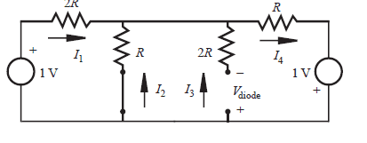

OK, so the first thing is to simplify the circuit by removing irrelevant components.

I attached a new drawing with the resistor removed. I kept the V_diode in there though.
Good first step. Now, looking at the original schematic, can you identify one of your new nodes with Vdiode(-)? Let us call the node Vdiode(+) = zero volts, shall we.
The node would be the wire between the 3 resistors.
But I still think you answer will not solve to be a number and will still depend on R.
You are correct on both counts. How could the answer not depend on R?
What I mean by that is if I1, I2, I4, and Vdiode will come out as actual numbers (i.e R ends up canceling out somewhere in the equation and you're left with actual numbers) or if it will come out as involving the variable 'R.'
i.e Vdiode maybe something like Vdiode=2R instead of something like 10V
The equations for the currents will all involve variable R.
