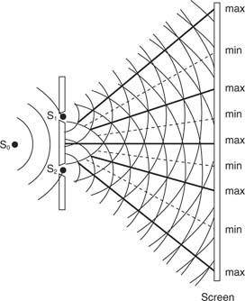

I know how to get the focus of the equation, that's not the question. My question is about the set of hyperbolas created by those foci. Consider a two point source at the locations of the foci, how do I determine the equations of ALL the hyperbolas associated with those foci. (Assuming that we have wavelength of 1).
In the above picture...If I know the equation of N3...can I easily determine the equations for N2 and N1?

The differences in distance to those foci have to be ... a-2, a-1, a, a+1, a+2, ... where a is some real number between 0 and 1, describing the relative phases of the emitters.
Calculate the distance difference for N3 and the focal points, reduce the distance difference by 1, 2, ... wavelengths.

Hi, I think there is an error in your drawing - the loci of "maximum constructive interference" should be straight lines.
This diagram is from "Young's Experiment" on double slit interference.
Did I misread your ideas?
This diagram is from "Young's Experiment" on double slit interference.Did I misread your ideas?
The loci are hyperbolae, hence the Hyperbolic Radio Navigation Systems. The Young's slits pattern that you show is an approximation, and only holds when the distances are greater than the separation. Note that the pattern in the original diagram also gives straight lines, well outside the region of the two sources.
