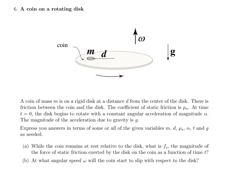

A coin of mass m is on a rigid disk at a distance d from the center of the disk. There is
friction between the coin and the disk. The coefficient of static friction is µs. At time
t = 0, the disk begins to rotate with a constant angular acceleration of magnitude α.
The magnitude of the acceleration due to gravity is g.
Express your answers in terms of some or all of the given variables m, d, µs, α, t, and g
as needed.
(a) While the coin remains at rest relative to the disk, what is fs, the magnitude of
the force of static friction exerted by the disk on the coin as a function of time t?
(b) At what angular speed ω will the coin start to slip with respect to the disk?
F_c=md(ω^2)

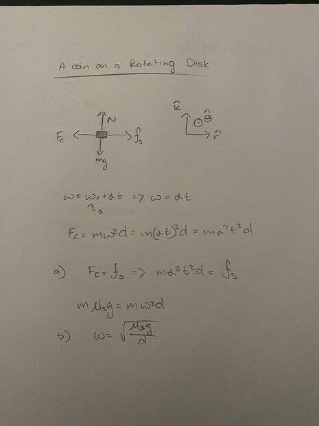

I believe I've solved this problem, however, I got through it pretty quickly and since it's the last problem on the assignment, I feel that I may have had an oversight.
For part a, I got: fs=md(α^2)(t^2)
and for part b, I got: ω=Sqrt((µs*g)/d)
Could someone confirm my answers? I've attached a picture of the problem and my work!

In part (a) you are correct that the net force on the coin is that of static friction. You are incorrect in assuming that the acceleration of the coin is only centripetal. You have to include the tangential component. That inclusion will, of course, affect the answer in part (b).

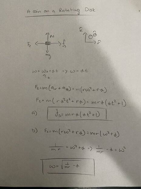

Got it, I tried again, not sure if I got it right though. Could you check it? One other question that came up as I was doing the arithmetic is whether the a_r should be a negative quantity or not.

It's not correct. ##a_c## and ##a_r## are acceleration components perpendicular to each other. You just don't add them as if they pointed in the same direction. Again, the net force on the coin is not centripetal, i.e. it does not point towards the center. Draw a free body diagram of the coin as seen from above.
Is the speed of the coin increasing or decreasing? That should answer your question.

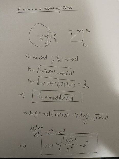

Does this look right?
AzimD said:
Got it, ya the issue regarding the acceleration components was an oversight by me. Rookie mistake.
Part (a) looks ok.
For part (b) what component of the frictional force will it overcome to slip?
I am not sure I understand what you mean. The coin will not slip as long as ##~F_{net}=m\sqrt{a_c^2+a_t^2}< \mu_s mg.##
I'm probably confused. Isn't the tangential component of the frictional force fixed? To me it seems that only the radial component evolves in time. If it isn't slipping immediately in the tangential direction at ##t= 0## why would it at some future time ##t##?
The expression ##f_s^{max}=\mu_sN## does not specify the direction of the force. Yes, the tangential component is fixed. However, what is relevant here is the resultant of the tangential and centripetal accelerations. This resultant multiplied by the mass is the net force. Its expression as a function of time is, as OP eventually got, $$F_{net}=m~\alpha~ d\sqrt{1+\alpha^2t^4}.$$At ##t=0## the net force is tangential. As time increases, it tips towards the center and increases in magnitude. When the magnitude reaches ##f_s^{max}## the coin will start sliding in whatever direction the resultant acceleration points at that instant in time.

No worries! Does this mean that I got part b correct?
Looks right to me.
