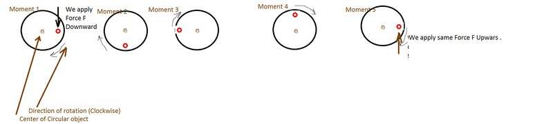

Hi. Is it convenient to ask following question.
Suppose we have solid circular object and 5 different moments
like in the picture:
Five-step diagram of a circular disk with a red dot off-centre; moment 1 shows a downward force F, moments 2 to 4 show the disk rotating clockwise, moment 5 shows an upward force F applied at the same point.
In moment 1 we apply force (downwars direction) so as to start rotating the object around center of
the mass (green dot) , Only rotational motion.
In moment 2-moment 4 the object is rotating around the green dot at the center of the object
(center of the mass), while the center of the mass is not moving.
In moment5 we apply upward same force as force applied in moment1 but in upward direction.
Will the center of mass of the circular object start moving in some direction.
In moment 5
Will there be also translational (not only rotational) motion ?
Will the center of the disk start going in some direction?
Thank you.
What does Newton's second law say about the motion of the center of mass of an object when you apply a force on the object?
The object is located in Perfect vacuum and no Forces except the Applied forces in Moment 1 and Moment 5 . No other forces. No Gravitation .

Will there be motion of the center of mass or the disk simply will stop rotating.
also you failed to define F but it seems they want you to assume it is an impulse or a very fast step pulse of F for a very finite time duration before it moves far, otherwise it starts to go down left and your time frame of 3 o'clock or your frame of reference for up may be wrong assumptions in 5. But if assume F is some impulse, it may stop in theory, but in practise, not as 0 risetime impulse forces do not exist except maybe in the big bang theory.
If you don't want it to translate, then in "moment one" you must apply a force equal and opposite ##F## to the systems center of mass.

So in scenario in picture we will have translational motion.
As @erobz points out, this is not consistent with your description of moment 1. If there are no other forces at that time, the disc starts to translate downwards at that time.
What happens at moment 5 depends on how you resolve this discrepancy.

Lets asume we have rotating disk without translational motion (Moment 2 - Moment 4),
In moment 5 we apply Force as shown in attached picture.
Will there appear translational motion ?
StoyanNikolov said:
We there appear translational motion ?
Depends why the translational motion didn't start in moment 1. What stopped it then?

Just consider the question Without moment 1.
We have rotating disk (only rotational motion) in Moment 2 and in Moment 5 we apply force.
Will in Moment 5 appear translational motion?
Thank you
Thank you
So long as we are clear that this is a different question from your original scenario, and that the disc is rotating in free space with no axle, then the answer is as in post #2.
What is the point of moments 2 to 4 in this new scenario? You have a rotating disk. If you apply any force to it, and this is the only force, the center of mass will accelerate in the direction of the force. What you did (or did not) before is not relevant.

Please also consider where the force is applied.
In moment 5
The force is applied
Not at the center of the disk (not at the center of mass of the disk)
but at periphery of the disk.
It makes no difference to the question you asked where you apply the force. You can't sneak around conservation of momentum.
So in Moment 5 there will appear Translational Motion?
StoyanNikolov said:
No it is not reactionless drive.
If there is a net force, it will translate.
Assuming there aren't factors you aren't telling us about, yes.
