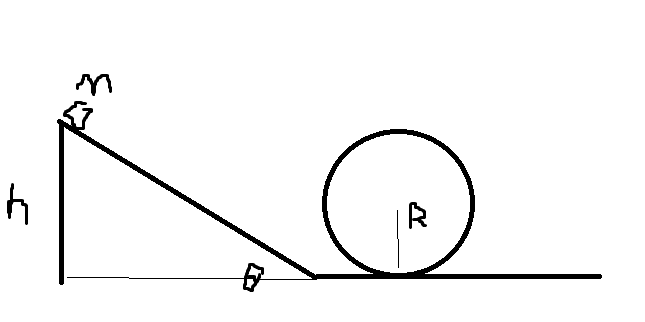

Bob starts at rest from the top of a frictionless ramp. At the bottom of the ramp, he enters a frictionless circular loop. The total mass of the child and the cart he sits in his m. What must the height of the ramp be in order for the cart to successfully traverse the loop.
r = radius of loop
h = height of ramp
theta = angle of the ramp (irrelevant though)
[/B]
I solved for the minimum speed at the top of the loop.
Fy = F + mg = mv^2/r
v= sqrt(rg)
I then used conservation of energy.
Initial : mgh
Final : mg2r + (m(sqrt(rg))^2)/2
mgh = mg2r + mrg/2
mgh = 5mgr/2
Cancel stuff out h = 5r/2 (WRONG)
Instead the solution calls for using kinematics not energy conservation.
v= sqrt(rg) stills hold.
vf^2 = vi^2 + 2ax
rg = 0 + 2gsin(theta)*(h/sin(theta)
rg = 2gh
r = 2h
h = r/2 (CORRECT answer)
I understand the mathematical process of the correct solution.
However, I don't understand why I can't use conservation of energy(gives me wrong answer) instead of kinematics.

The second answer (r/2) is clearly wrong since it would not provide enough energy to reach the top of the loop even with no remaining KE.
The calculation goes wrong because it equates the speed at the bottom of the ramp to that required at the top of the loop.
The first answer is correct.

Is there any additional information that would make solving this question using kinematic possible, then?
The v2-u2=2as equation is effectively KE+PE constant. All that's different is factoring out the mass.
