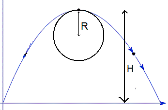

a stone is projected at an angle with the horizontal with velocity u. it executes a nearly circular motion near its maximum height for a short time. the radius of circular path is
answer is u2 sin2x/g3. The Attempt at a Solution
why isn't it is just the maximum height?

i just want to know the radius of the circular path exhibited by the stone at the top of its path
""why it isn't the maximim height"" i mean that answer should be the mximum height attained by the body
no it won't be max height
like in this case:
H is max height but radius is R
like in this case:
yeah... thnx
but still don't know how to find R ??
(Its late now ... must sleep or take steroids :zzz:)
use the eqn:
[tex]a_{radial} = \frac{v^2}{Radius}[/tex]
and here v will be tangential to the curve obviously
(off to sleep :zzz:)
thnx man.. jus got it right
hi vipulgoyal! :smile:
it is asking you for the radius of curvature at the top
hint: what is the speed at the top? :wink:
