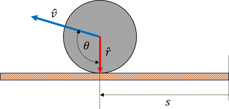

  • #32
For the angular velocity at any instant in time if the wheel is not slipping, I can't see how the relationship is invalid?
$$ \hat{v} = \hat{r} \times \hat{\omega} = | \hat{r} | ~ |\hat{\omega}| \sin \theta = r \omega \sin \theta \hat s = v(s) \hat s $$
I think the angular kinetic energy is simply as it was:
$$KE_{rot.} = \frac{1}{4} m(s) v(s)^2 $$
and it was the translational energy that needed to be adjusted?

jbriggs444 said:
Life is more difficult if we shift from the hypothetical cylinder to a more realistic archimedean spiral. The moment of inertia is trickier. The local curvature of the slope-facing surface of the spiral is more difficult to calculate. One would want that to compute the velocity with which the point of contact is advancing down the slope.
We have to stop somewhere or (I think you will agree) there practically is no end to this.

  • #37
$$ \hat{v} = \hat{r} \times \hat{\omega} = | \hat{r} | ~ |\hat{\omega}| \sin \theta = r \omega \sin \theta \hat s = v(s) \hat s $$View attachment 329251I think the angular kinetic energy is simply as it was:
See retraction in post #21. Sorry about the confusion.

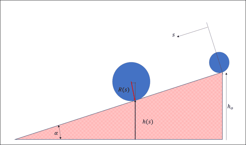

  • #38
Ok.
Well my final go would be:
$$ m_o g\left( h_o + r_o \cos (\alpha) \right) = \frac{1}{2} ( m_o + \beta s ) \left( 1 + \left( \frac{\beta}{2 \rho \pi L } \right)^2 \frac{1}{ r_o^2 + \frac{\beta}{\rho \pi L} s} \right) v(s)^2 + \frac{1}{4}( m_o + \beta s )v(s)^2 + ( m_o + \beta s ) g \left( h_o - \sin (\alpha)~ s + \sqrt{ r_o^2+ \frac{\beta}{\pi \rho L} s }~ \cos (\alpha) \right) $$
Its not pretty, but I'll plot ##v(s)## when I get a chance to see if it fixes the issues I found in the last model.
  • #40
erobz said:
Ok.
The model doesn't seem to correct the issue with ##\beta## having an upper limit ( in fact it shrinks it). I can't figure out what it means.
Here they are plotted:
