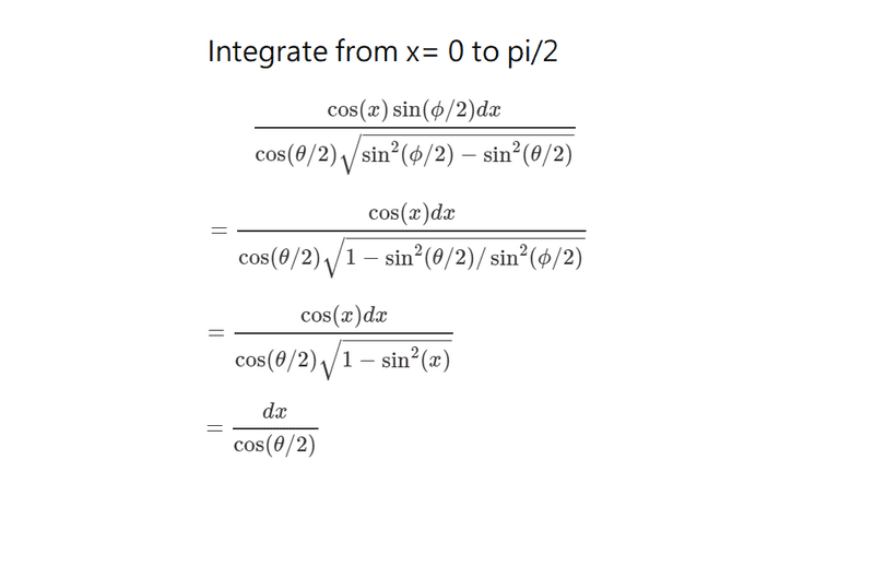

Handwritten-style typeset derivation: the heading reads Integrate from x = 0 to pi/2, followed by a chain of fraction steps simplifying cos(x) sin(phi/2) dx over cos(theta/2) times the square root of sin^2(phi/2) minus sin^2(theta/2), ending at dx over cos(theta/2).

This is all very confusing. What is ##\phi##? The radical in the first line of your development should be ##\sqrt{\sin^2(\theta_0/2)-\sin^2(\theta/2)}##. Also, the rest of the stuff in the integrand doesn't look right either. Please show your steps in more detail.

Ummm phi is theta o ...and I changed the integral in part a to the integral in the attempt by substituting x = sin(theta/2) / sin ( theta o)
Then dx = cos (theta/2) / 2sin(theta o) d(theta)
I think you're OK so far (after realizing that ##\phi = \theta_0##). In the expression ##\frac{dx}{\cos \left(\theta / 2 \right)}##, express ##\cos \left(\theta / 2 \right)## in terms of ##x##.
(I am using a as theta and b as theta o because I can't type them)
dx/cos(a/2) = dx / √(1-sin^2(x)sin^2(b))
So its approximation is
dx / {1-sin^2(x)sin^2(b)/2} ?
EDIT: Did you mean to have (b/2) as the argument in sin2(b)?
You can continue to simplify this using the fact that b is small.

Another approach is to use the small angle approximation directly on ##\frac{1}{\cos \left( \theta /2 \right)}## rather than first expressing ##\cos \left(\theta /2 \right)## in terms of ##\sin \left(\theta /2 \right)##. But your method will work also with about the same amount of effort.
