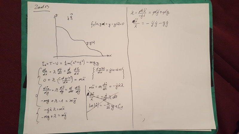

To be honest I am completely lost. This is so abstract with not even a function given that I don't know how to specify the initial constraint equation. Normally there would be y and x in it, so I wrote f(x,y) = y - y(x) = 0, which feels weird ...
I wrote the Lagrange equations based on that weird constraint, but even if that would be good I have no idea how to get Lambda from that :(

Hello.
It is preferable to type in your work rather than post pictures of your work. That way, it is much easier for helpers to quote specific parts of your work. (Posting pictures of diagrams is fine.)
I think you are on the right track, overall. The way you set up the constraint equation as ##f(x, y) = y - y(x) = 0## looks correct.
However, the equation circled below is not correct

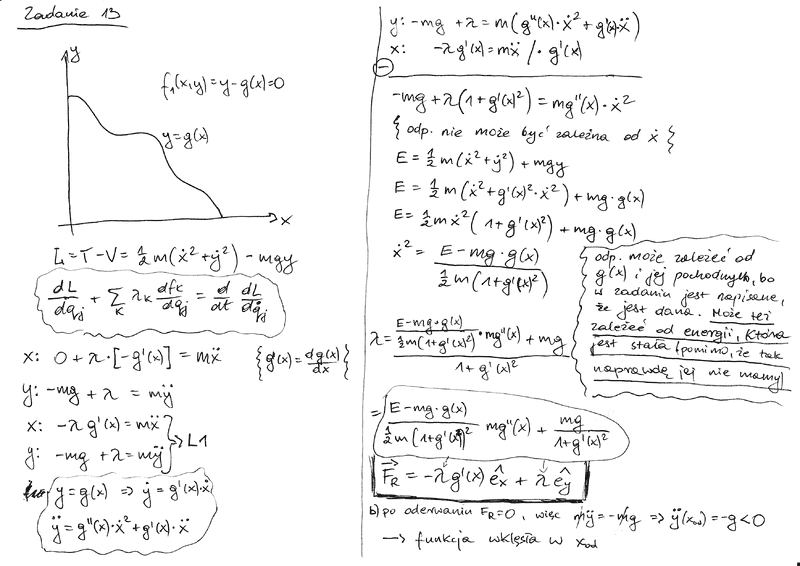

Hey, sorry for not responding immediately. Thanks for the tips, I think now I got it right, so I'll upload it for people who might lurk in this thread.
Sorry for the Polish comments, I wrote that the answer can not depend on dx/dt, but it can depend on Energy which is constant and on derivatives of g(x).
And in b) that when the skier detaches from the slope - there are no reaction forces, so my'' = -mg

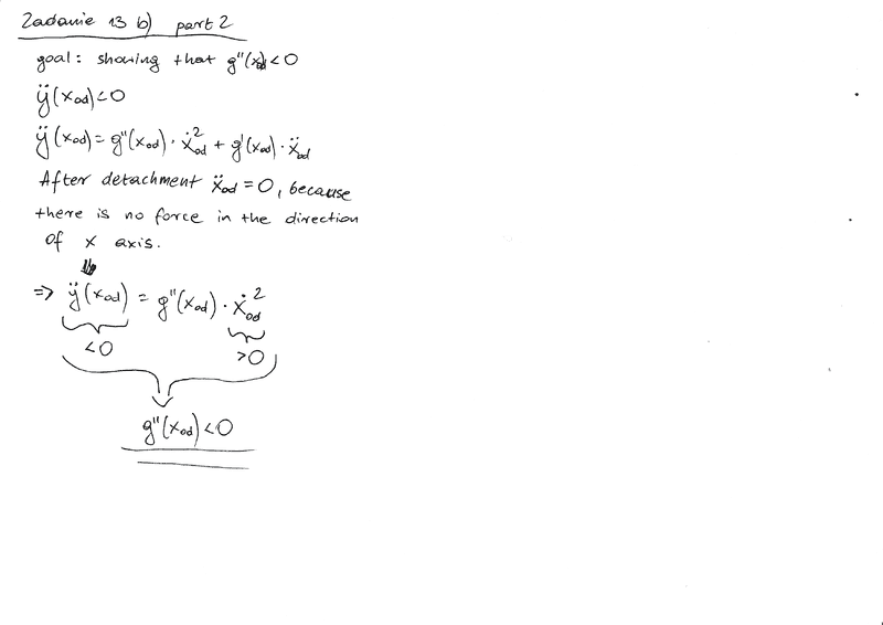

OK. Part (a) looks good to me. For (b) you showed that ##\ddot y(x_{od}) < 0##. Did you show that ##y''(x_{od}) < 0## ?
Oh damn! Thanks for lettng me realize it's not the same :p
This should do I think
Yes. Or you could let ##\lambda = 0## in
