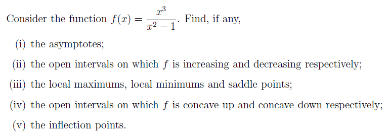

Printed problem statement: the function f(x) = x^3 / (x^2 - 1), followed by a list asking for (i) the asymptotes, (ii) intervals of increase and decrease, (iii) local maxima, local minima and saddle points, (iv) intervals of concave up and concave down, and (v) inflection points.
1)
I found the asymptote as (+/- 1)
2)
Let f(x) = y;
dy/dx = -2x^2 / (x^4 - 2x^2 + 1) = 0
-2x^2 - 0
x = 0;
Since f() != 1, f(2) > 0 Increasing
Since f() != -1, f(-2) < 0 Decreasing
So i guess range is increasing or x >=2, decreasing for x<=-2
3)
Since x = 0, how find local max or min or what the toot is saddle point..

Your first derivative dy/dx is wrong. Use the quotient rule!

I think you've differentiated that incorrectly, remember to use the product (or quotient) rule.
