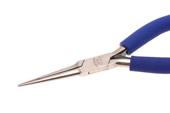

I like these miniature needle nose pliers . The jaws are flexible enough you can grab delicate parts without bending them.
Sears, Xcelite, Klein all have them. Sears sells a set of 3 different pliers handy for electronic & light electrical work, including this one..

Needle nose jaws should meet first at the tip and contact should progress backward toward handles as you tighten your grip.
Likewise diagonal cutters. Hold them up to a light and check that before you buy. Cheap ones will only frustrate you.

What is the "tip" and what is the "contact ?
Look at this picture of a needle nose plier with its jaws just closed. Tip is at the left end.
Do you see that the jaws touch one another only at the tip? That's contact.
If you held the plier up to a window you'd see daylight between the jaws over the remainder of their length.
If the jaws' first contact is anywhere short of the tip, either they are bent from abuse or the plier is so el-cheapo the manufacturer doesn't mind making junk.
LongApple said:
What do you mean by progress back towards handles?
As you squeeze the handle the jaws deflect.
Press the fingertips of your left hand against those of your right and push your hands toward one another.
Your fingers will lay against one another. The jaws do same thing.

Another thought - you might find a hemostat to your liking. I keep one handy for breadboarding.
http://www.pjtool.com/images/products/detail/4356.jpg
good needle point tweezers, approaching from the side parallel to the breadboard. grab as close to the breadboard as possible and gently lift.
use two if you want to lift both ends at the same time. Or, if you bend your wires flat, insert at the bend and lift.
There are all sorts of tweezers to fit however you dress your wires.
or, these curved tweezers
Or these blunt ones:
