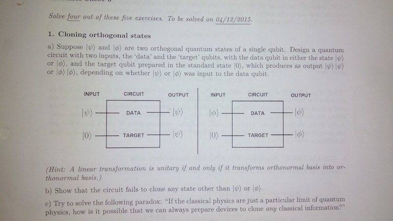

Hey, the no-cloning theorem states, that arbitrary quantum states cannot be cloned by any circuit.
It is, however, possible to clone orthogonal states.
What would a circuit performing this action look like?
Relevant equations: I am assuming you all now the most important quantum gates (CNOT, Hadamard, Pauli Matrices etc. )
The circuit looks like this:
##|\psi\rangle## is a general qubit: ##|\psi\rangle := a |0\rangle + b|1\rangle##
I am assuming a CNOT gate has to be applied at some point, followed by the application of further gates to the lower qubit. I am, however, not sure how the coefficients can be "transferred" to the lower qubit.Thank you!
What state do you get after the application of the CNOT gate?
