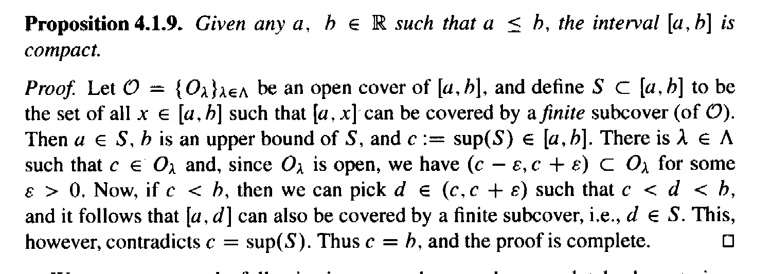

Closed and Bounded Intervals are Compact ... Sohrab, Proposition 4.1.9 ... ...
I am reading Houshang H. Sohrab's book: "Basic Real Analysis" (Second Edition).
I am focused on Chapter 4: Topology of [FONT=MathJax_AMS]R and Continuity ... ...
I need help in order to fully understand the proof of Proposition 4.1.9 ...Proposition 4.1.9 and its proof read as follows:
My questions are as follows:Question 1
In the above proof by Sohrab we read the following:
" ... ... Now, if $$c \lt b$$, then we can pick $$d \in ( c, c + \epsilon )$$ such that $$c \lt d \lt b$$ ... ... "My question is as follows:
How (... rigorously speaking ... ) do we know such a $$d$$ exists ...
In other words, what is the rigorous justification that if $$c \lt b$$, the we can pick $$d \in ( c, c + \epsilon )$$ such that $$c \lt d \lt b$$ ... ...?
Question 2
" ... ... Now, if $$c \lt b$$, then we can pick $$d \in ( c, c + \epsilon )$$ such that $$c \lt d \lt b$$, and it follows that $$[a,d ]$$ can also be covered by a finite subcover. i.e. $$d \in S$$ ... ... "Can someone please explain why/how it follows that $$[a,d ]$$ can also be covered by a finite subcover. i.e. $$d \in S$$ ... ... ?
Help will be appreciated ...
Peter

Hi Peter,
For question 1, since $c<b$ and $\epsilon>0$, you can take $d$ between $c$ and $\min(c+\epsilon,b)$.
For question 2, since $c<d<c+\epsilon$, and $(c-\epsilon,c+\epsilon)\subset O_\lambda$, $d\in O_\lambda$, and you can add $O_\lambda$ to the finite cover of $[a,c)$ to get a finite cover of $[a,d]$.
Hi Peter,
My answer of question 2 is not quite correct. In fact, we do not necessarily have a finite cover of the interval $[a,c)$ (which is not compact).
We do not know if $c\in S$. What we do know is that, for any $x$ with $a<x<c$, we have a finite cover $U_x$ of $[a,x]$. We can take $x$ between $c-\epsilon$ and $c$, which gives the inequalities:
a<c-\epsilon<x<c<d<c+\epsilon
Now, $U_x$ covers $[a,x]$ and $O_\lambda$ covers $(c-\epsilon,c+\epsilon)$ (which contains $d$); therefore $U_x\cup O_\lambda$ covers $[a,d]$; this means that $d\in S$, which contradicts $c=\sup S$.

Thanks for the guidance and assistance ... and the correction ...
