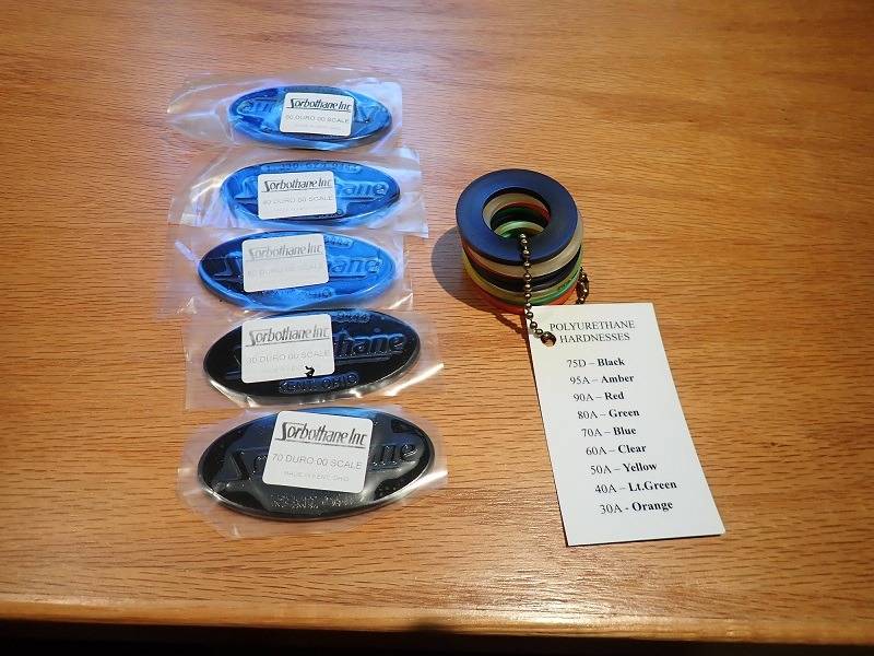

Go to the McMaster-Carr website at https://www.mcmaster.com/, then enter elastomer sample pack in the search window. The price of one or several sample packs is cheap compared to the value of having something to hold and pull on. The photo shows a typical pack that I bought several years ago when I had a similar question:
There are several different durometer (search the term) scales. The 30A and 40A durometer have similar stretchiness as rubber bands.
Then search urethane and elastomer on that web site. Some urethanes can stretch to as much as 5 times their original length. They also have castable urethanes. Those work, but it's difficult to get the air bubbles out. Something I learned the hard way.
Likes berkeman, sysprog, ktoz and 1 other person

Thanks for the info! Seems like a good way to get an intuitive feel for the various types.

Take a look at square section O-rings. Here's a supplier (not the only one, but they have a good website): https://www.mcmaster.com/o-rings/square-profile-oil-resistant-buna-n-o-rings/.
You could get the width you want by gluing two or more together. O-rings last a long time, and are available in different materials with different stretchiness.

Thanks. I’ll look into it. Ordered the elastomer sample pack from them Sunday.
