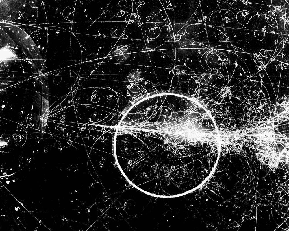

The magnetic field is sometimes added just for distinguishing electrons from positrons and that's when you actually see strong spirals, but I don't think you could make a high enough magnetic field in a DIY cloud chamber. Also note that those representations do not seem anything like a spirals from an electron or positron in a cloud chamber with the magnetic field (bubble chamber below).

My issue was with the smooth curves. All the electron pictures I'd seen were erratic, not smooth curves. The near reversal of direction also seemed unusual, though I suppose this should be possible.
The only reason for the smooth curves would seem to be a magnetic field, but with the reversal of curvature and the variation in radius both increasing and decreasing on the smae track, that didn't seem plausible.
Your video is the first time I've seen a track like that.
