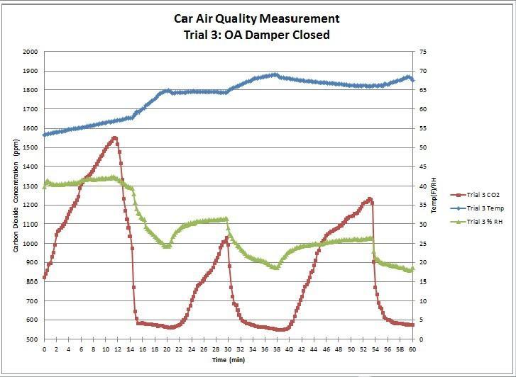

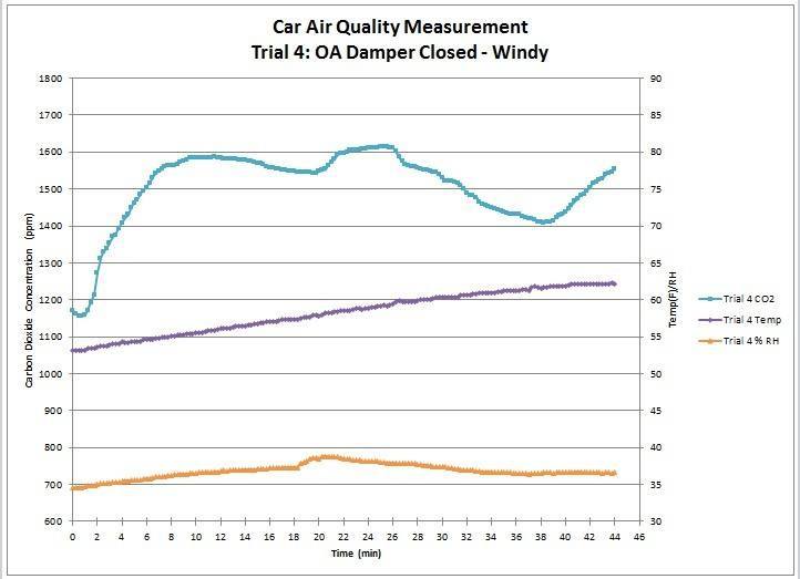

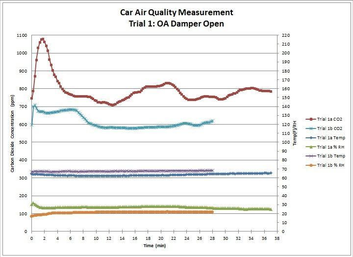

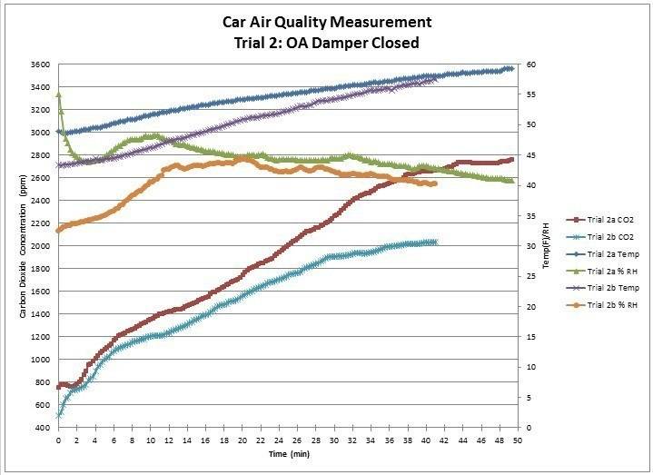

I've just spent some time trying to find any guidelines/regulations on ventilation in cars. I can't find any with a casual google search but I'd be shocked if they didn't exist, at the very least there's probably industry data somewhere on the natural airflow in cars. I agree with those saying CO2 build up is very unlikely, given the ubiquity of cars and long distance driving this would have been a famous issue discovered and solved long before now.
Ivan Seeking said:
I just don't take arm waiving arguments as convincing; especially given the calculations already done and the paper cited.
The calculations look nice, but since they don't take into account the most important factor, they really aren't worth much*. And you didn't provide a relevant paper.
Look, if you really want to know for sure, CO2 monitors start at about $120 on Amazon. I'm always looking for an excuse to pick up a work relevant tool, so I may get one too.
*No offense guys: it looks like a nice lower bound calculation, but when it scares the OP into taking it too seriously, it can be counterproductive.
256bits said:
ASHRAE standards set it to around 700ppm, as being indicitive of insufficient air exchange ( accumulation of other human volatiles would be more noticable than CO2 buildup )
That's 700 ppm over ambient, which is about 500-700 itself.
Everything else is good. Yes, the 1000 ppm threshold was far too low to notice the kind of effect Ivan observed.

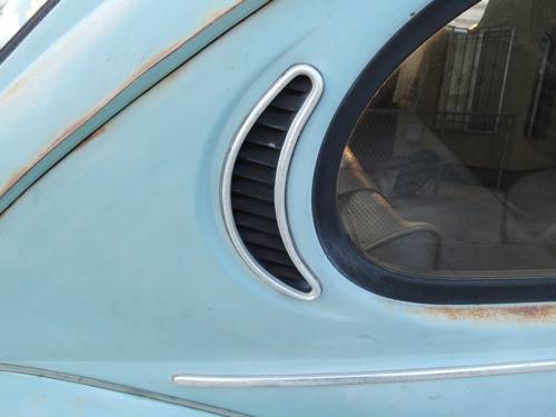

Here's an interesting article that says the old VW Bug was made too air-tight (on purpose?), which made the doors hard to close and made hurt your ears:
http://auto.howstuffworks.com/under-the-hood/diagnosing-car-problems/body/car-air-tight.htm
And video:
I was going to bring up the VW as one of the very very few cars that had been made too air tight. almost all other makes of cars have a near built in level of leakage including through the back seat into the trunk which allows the doors to close without arm breaking strength to do it and not popping the passengers eardrums.
