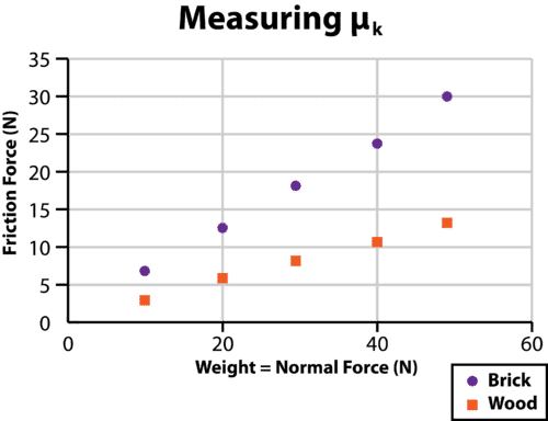

If the normal reaction force is doubled, the coefficient of friction is-
##F_r(friction)=\mu F_N(normal)##
The answer should be no change but we know ##F=ma##. In this eqn when acceleration increases mass decreases for same force. So why not here? If normal is doubled ##\mu## should be halved.
The equation that you quoted is only an upper limit for the maximum force of static friction. The correct expression is ##f_{static}\leq \mu_s F_N##. Unlike its kinetic counterpart, the force of static friction does not have a specific value. It is whatever is necessary to provide the observed acceleration but up to a certain limit that it cannot exceed.
It's like going to a store to buy a $20.00 shirt with a credit card that has a $500.00 limit. You charge to the card whatever is necessary, $20.00, not $500.00 which is the maximum you can spend. If the credit card company increases the card's limit to $1,000.00, you will still pay $20.00 for the shirt. Increasing the limit of your credit does not increase the cost of the shirt. Likewise, increasing the normal force does not increase the static force that is necessary to provide the observed acceleration. It increases the upper limit that static friction can have.
On edit: This applies to static friction. For kinetic friction the equation is always valid. The coefficient of kinetic friction is a measure of how slippery the contact is. See post by @Lnewqban below for more.

Note that the coefficient of friction is unit-less, being a coefficient of linear proportionality in a graph showing Friction force versus Normal force.

Mister T said:
In the first example involving ##f=\mu N##, we know from experience that ##\mu## is constant.
In other words, ##\mu## is independent of ##F_N##. That is why when you look up tables of coefficients of friction between various materials, the normal force is not mentioned and can be anything.
