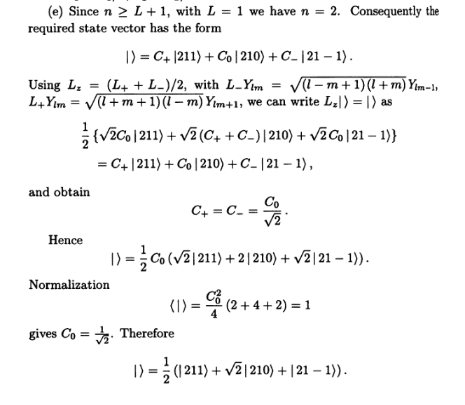

Just to make sure, here is the problem (part e):
Printed problem 2012 on hydrogen atom wave function at t=0: psi(r,0) = (1/sqrt(10))(2psi100 + psi210 + sqrt2 psi211 + sqrt3 psi21-1), with parts (a) to (e) asking for energy expectation, probabilities, time evolution and post-measurement state.
And here is the solution:
Worked solution of a quantum angular momentum problem: the state vector |> = C+|211> + C0|210> + C-|21 -1> is rewritten using Lz = (L+ + L-)/2, yielding C+ = C- = C0/sqrt(2), normalization C0 = 1/sqrt(2), and final state |> = (|211> + sqrt(2)|210> + |21 -1>)/2.
Unless I'm missing something, they just seem to ignore the part where Lz is measured. If they only measured L = 1, this seems like it would be the right answer.
As I supposed, there was a misunderstanding in the notation.
The book says that [itex]L_z= \frac{1}{2}(L_+ + L_- )[/itex], this means that the quantum number m is the eigenvalue of [itex]L_y[/itex] ([itex]L_-[/itex] lowers m by 1).
I hope this solves the problem^^
Ilm

Ok, I see that because of the symmetry, that makes sense. But it seems like nowhere in the question does it say that m is the y component of angular momentum, and it's been z everywhere else I've seen it. Is there something I'm not seeing where they make it clear that m is the y component, in the question?
Absolutely not.
I can only see it from the answer given by the book.
I suppose it's the standard notation of the book?
Ilm
