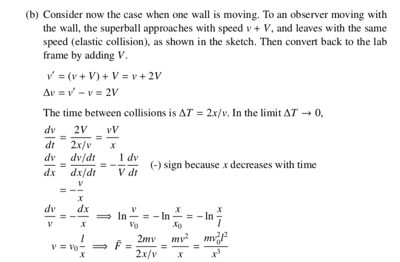

I have problem with the solution given of the (b) part of the question.
The given solution is :
I did not understand why the value of ##\Delta T = 2x/v## even when ##\Delta T \to 0## ?
Since if the time taken for collision reduces so does the distance between the wall and the ball and since velocity is constant. The value should be ##0##. No ?
The value of what should be zero? And why do you expect velocity to be constant?
Oh sorry, I mean the value of ##dv/dt## should be infinite.
I expect the value to be constat because it is given in the question that the ball moves with a constant velocity.

As I read the question, no such thing is given. The speed increases with each bounce.
If v was not constant then how does we got ##\Delta T = 2x/v## in the first place ?
Because V << v and because v is increasing, it is a good approximation that gets better and better.
I am sorry, I did not follow how does velocity of wall has to do anything with the velocity of ball ? Can you elaborate on it please.
The velocity of the ball changes at each bounce from a moving wall. How much it changes depends on V.
Also, how much x changes during a round trip depends on V.
I can buy that explanation.
