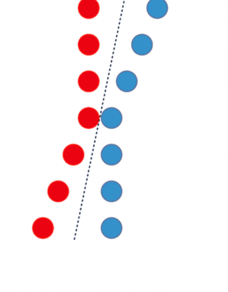

Now i am thinking about an analogy. So if two identical vertical pendulums with the bobs on their tops and drop them in such a way that they crash, they will bounce back, rotating in the opposite direction. kinda like how a head on collision of two same speed and mass particles will just make them bounce back.
I imagine that the particles on the surface of the ball act the same way. Microsopically, the first particles that hit should hit at an angle slightly above the horizontal, giving a backwards rotatory bounce.

ok so then they collide right at the horizontal, and the y momentum of the two rim particle that collided would be conserved. Well if this collision took place in outer space. In in the pic where red and blue are the rim particle that collides.
Except that on the table, this vertical impulse would cause a impulsive response from the table. And on the table, the table cannot respond x impulse since its directed parallel to the table.
What vertical impulse? You have two particles with the same vertical velocity colliding. The resulting force on both would be purely horizontal.
Makes sense. The line of contact is horizontal.
In that case, there is no vertical impulse and the normal force from the table remains unchanged.
