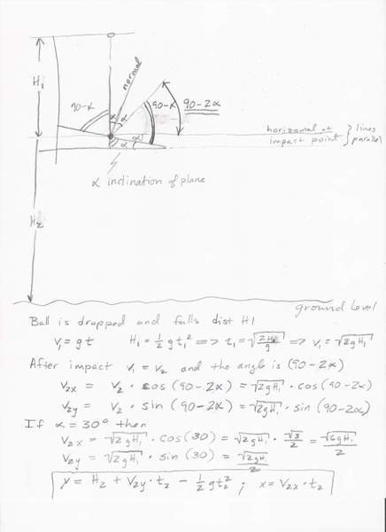

see diagram and compare to your angles
okay so in order to get the angle, you compared your x axis, with the two forces of normal..
and you subtracted the two 2Alpha from 90 degrees, because that is that quadrant...
parallel lines are referring to the bottom of the plane being parallel with the axis?
And thanks a lot for spending your time man. i really appreciate this. I'm just asking a lot of questions, so that in the future if i ever encounter a similar problem i under stand things better, and geometry has never been my strong suit.
also i solved the for time using the quadratic formula..
i ended up with t=[√2H2] by simplification... but this doesn't seem right in terms of units... However when i solve for my final answer...
I get L = [√3]H2
as my answer.. could you please tell me if this is correct?
the (90 - 2 α) is the angle of elevation. Sometimes diagrams be misinterpreted especially if angles like 30 or 45 degrees are used. I also try 80 and 10 degrees to see if there anything I missed in my answer.
yes and your units of measure are wrong for the time. Thats a good way to check whether your solution is reasonable. I used the same method to check my eqns on the scanned paper.
I don't think I can help you any more as you really need to think about the solution. There are two problems here:
- in the first you determine the speed of the ball once it hits the incline and then you use your knowledge of
reflection to determine the angle of 90-2α.
- The second problem is given the speed of the ball, the angle of elevation and the height above the ground
you can compute how far it will travel before it hits the ground.
My initial post was because I thought I saw the source of your error and so corrected it to be (90 - 2*α)beyond that I feel I will confuse you more. Try to work it out as two problems and forget what everyone including me have written has written. On my scanned paper are the equations for the vx, vy, x and y. Use the y eqn to determine the time the ball hits the ground and then use that in the x eqn to get the dist and you will be done.
