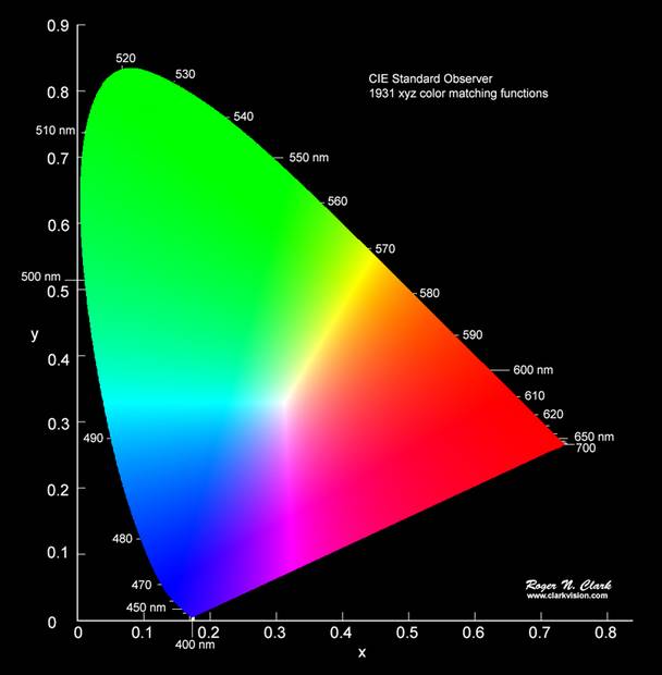

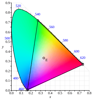

Indeed, but we need to be careful on how we define "color."
For example, one could make two light sources:
(a) a combination of 612 nm and 549 nm of light, each wavelength having some relative amplitude, and
(b) a single wavelength of 580 nm of light.
If the relative amplitudes in (a) are adjusted just so, a typical trichromat could not tell (a) apart from (b). To the trichromat, they are "the same color." If we were to plot these two light sources on a chromaticity diagram, they would correspond to the same point, i.e., the "same color" (a linear combination of three colors, R, G, And B, map to a single point on the chromaticity diagram).
Figure 1. Example chromaticity diagram. This [two dimensional plot] is adequate for trichromats, but would need a new [third] dimension for tetrachromats.
The source (a) could be displayed using an RGB computer monitor. Source (b) cannot.
A tetrachromat, assuming they actually exist in humans in the first place (which is somewhat debatable), could tell the difference between (a) and (b), and more-so, the tetrachromat might claim that no computer monitor they have ever seen could reproduce (b).
If tetrachromacy actually exists in humans, and we wanted to reproduce "colors," as tetrachromats see "colors," we would not only need to revise our computer monitors and displays, but we would even need to modify the way our files store color data. Storing and displaying color data in RGB format would not be enough: we would need a new value to the mix, perhaps by adding yellow, Y, and displaying and storing color data in RYGB format.
Ignoring RGB constrictions. We could look at the real world through a broad filter, that would allow us to differentiate colours by brightness, that otherwise would look the same.
I'm just not convinced this is the whole story.
For what it's worth, let me state for the record that I'm not fully convinced that human tetrachromats even exist in the first place. The evidence for their existence seems a bit sketchy to me.
That said, there are people who claim to be tetrachromats. And there is some solid, biological evidence that some women actually have a 4th type of color receptor. And if it is accompanied by correspondingly separate mechanism of getting that 4th type of information to the brain, then maybe yes, there is tetrachromacy in some humans.
And there's plenty of evidence that even higher dimensions (e.g., pentachromacy) exist in the animal kingdom.
In other words, while I'm not convinced tetrachromacy exists in humans, I'm open to the possibility.

DaveC426913 said:
I don't see why this effect would not extend to an RGB monitor.
The tetrachromat would be able to distinguish between RGB(000,133,059) and RGB(000,133,069) easier than we trichromats could.
It's kind of the colour equivalent of triangulation. They have an extra sensor at a different wavelength, than we do, to zero in on a colour contrast.
"Triangulation" is quite apt here. We, as trichromats can triangulate a three dimensional color (using three primary colors such as red, green and blue) onto a two dimensional color wheel, or a chromaticity diagram if you prefer.
Figure 1. Example chromaticity diagram. In such diagrams the intensity/luminosity/brightness is not indicated in the diagram; only the color quality is shown. In this way, 3-dimensional color vectors (that include brightness) can be projected onto a 2-dimensional color space diagram (which does not include brightness).
But if you had a 4th receptor, complete with all the biological mechanisms of passing that information back to the brain, the color information would not be 2-dimensional, it would be 3-dimensional and span a volume rather than an area.
Again, it would be like telling one of the hypothetical bichromats that "green" is qualitatively different than just a slightly different shade of magenta. We (trichromats) see the chromaticity diagram (Fig. 1) as two dimensional, while the bichromats are convinced that chromaticity is simply composed of a 1-D line.
So your example of "RGB(000,133,059) and RGB(000,133,069)" does not apply to a tetrachromat. You need four data points (a 4 dimensional vector) to fully represent the qualitative color (including brightness information) to a tetrachromat, not three.
