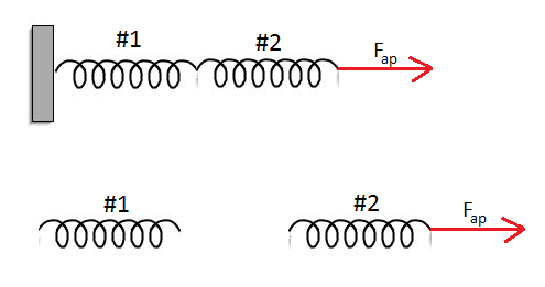

In the figure below I have shown the two springs being pulled by your applied force Fap. Below that, I have drawn the two springs separately for the free body diagrams. Can you complete the diagrams by describing what other forces should be included in the free body diagrams?

Foopyblue said:
My Force = Force of Spring 1 + Force of Spring 2
A spring doesn't exert "a force" (singular). Only when you consider one end of the spring pulling on a free body can you define the force due to the spring. When you use a symbols like "F" without explanation it isn't clear which force you are talking about. If "F" represents the magnitude of several different forces, you should explain that too.
To define what your symbols represent, draw (or describe) some free body diagrams.

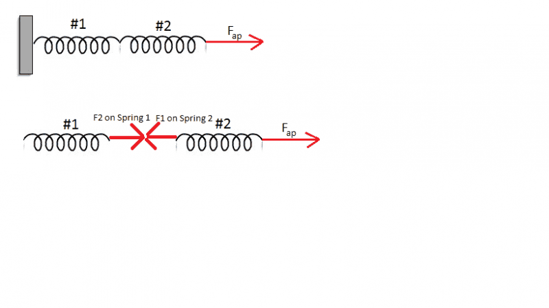

I have this so far. I'm not sure if I am missing anything. I know I've already said this, but this situation is very difficult for me to visualize for some reason.

Good. You are only missing one force that acts on spring #1.
I've scratched my brain but I don't have any idea. Does it have something to do with the opposite force of the applied force?
