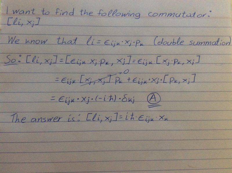

The problem statement can be seen in the picture i uploaded.
The attempt to the solution can be seen in the picture i uploaded.
I reached to the A and i don't know how to proceed to the solution that is given below. How does the minus and δkj disappear?
If i do the double summation on k and j I think that every term gets zero either because of εijk (levi-cevita) or δkj (kronecker)
You used the index j twice: once for the index on x and then again as a dummy summation index when writing out the angular momentum in terms of the levi-civita symbol.
I can't see why this is wrong ... :/
Moreover , if i use , let's say the index m on x (not on x that comes from angular momentum , yes on x that is alone) , then i still have the minus on ih bar ... My solutions say that it should not be there ...

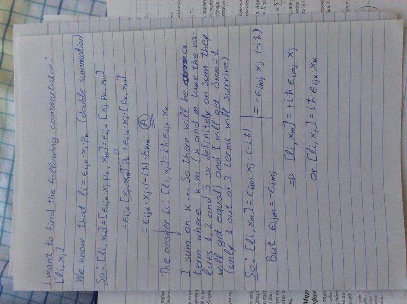

Ok i think i understand why i can't have the same index on these two .
Moreover i think i found how i get rid of this minus ...
I must use the fact that εijk=-εikj wright ?
Is now the solution correct ? (Uploaded photo)
Yes. That looks very good.
Thank you very much for your help :D
