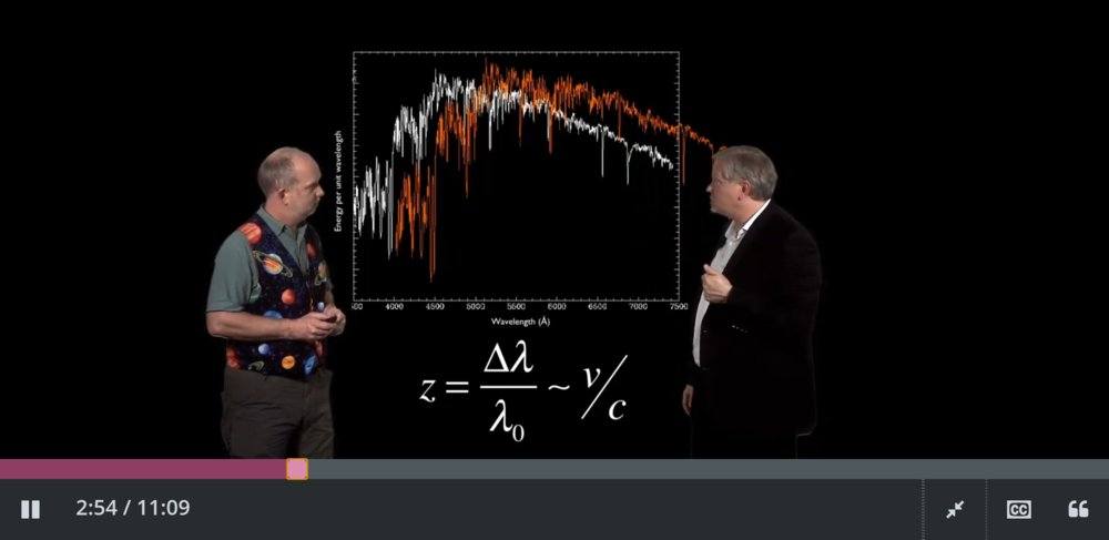

see the screenshot
So tell me if I'm wrong, the left spectrum (white) and the right one (red) show spectra of two different galaxies (with different distances), right ?
Why is it possible to know the velocity of the red-shifted spectrum by comparing it to the left one ??
Ellio said:
Homework Statement:: none
Relevant Equations:: see the screenshot
The spectra have the same shape so you can just look at what the wavelength shift is for one of the peaks or absorption lines.
