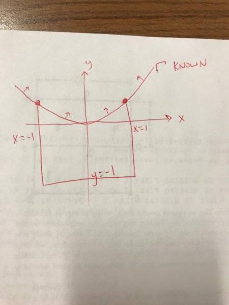

I read both your posts, but I think it's a little beyond me. However, after reading, I think I have a little clarity I can shed. Referencing post 5, I'll say the basis functions ##\phi## must be harmonic and satisfy ##d_x\phi(x=\pm 1) = 0, d_y\phi(y=-1) = 0##. These are easy to find, specifically they are sines and cosines multiplied with hyperbolic cosines. The last BC requires ##\phi_n(x=\pm 1) = 0##, where ##n## denotes a normal derivative to a curve ##\Gamma## (see picture). The ODE ##L\phi_n(s) = -\lambda \phi(s)## I described above is only a function of ##s## (rather than ##x,y##) since it is evaluated on the curve ##\Gamma##.
My question is, when I evaluate the weak formulation and enforce BCs ##\phi_n(x=\pm 1)## I get different results than when I do not enforce BCs. Again, I enforce BCs by superimposing the harmonics. Any ideas why this would happen?
  • Hand-drawn sketch in red ink of a square region below a parabola-like curve labelled KNOWN, with x and y axes, lines x=-1, x=1 and y=-1 marked, and arrows on the curve.

I'm approximately solving a differential eigenvalue problem. The basis functions I use must satisfy the BCs with the EVP. Since they also must be harmonic and satisfy the derivatives I mentioned earlier, I find them generally for those conditions, and then superimpose to satisfy the final BCs. Then I apply a Ritz procedure to them to approximately solve the ODE.
There are two ways to solve: solve the inverse EVP, which introduces a Green's function. In that case, I don't have to recombine basis functions since the Green's function accounts for these. This approach is correct. The second way to solve the EVP is the direct approach. In this approach, I recombine the basis functions, and in this approach I get an incorrect solution for some (not all) parameter values. I just don't know why.
Basis functions work, but when recombined, suddenly the technique can fail. You've never seen anything like this?

No, sorry, it has been a while since I have done PDEs or worked with Green's function in general.
