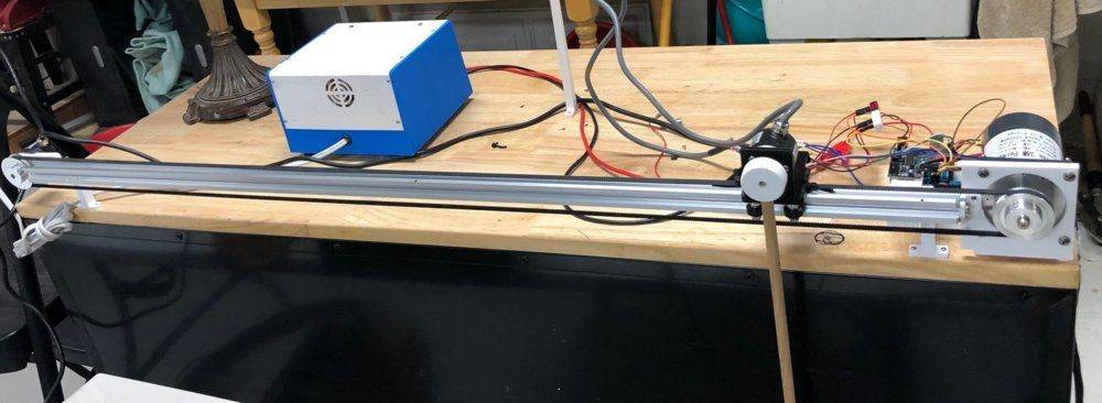

I think a picture will help here. In some systems the motor drives wheels to move the cart. In this system, the motor drives the cart directly on the rail. This is an older pic with a DC motor. It has been changed to a stepper for more precise control.
The optical encoder on the left end monitors the position and the optical encoder on the pendulum determines the angle.
As I think about what you are saying in your last post, I think what you are saying is, instead of trying to determine the force on the cart or the speed of the cart, I should be looking at the position of the cart.
If that is the case, the position of the cart is measured in meters from the center of the rail and can be positive or negative. I don't think I can simply substitute a distance for Fc. Something else in the formulas must be changed.

Absolutely it is not the same. Force on the cart and position of the cart are related by Newton's equations and there is also the force from the arm on the cart. The control equations will be different in more or less complicated ways. This is a very good project but one that will require you to learn some control theory. If you wish to attack this be prepared to derive actual control equations and you will get criticism and guidance here.
I'm speculating here. If I chose to revert to the DC motor instead of the Stepper Then FC would be force on the cart and through testing and measuring, I could make a map of the motor's applied force at different PWM levels. I'm guessing that would allow me to work with the formulas as given in the Stanford document.
Steppers are very different animals. They will provide step control until a max torque is reached and then they don't. Better you learn to do the balance by actually using the position control of the stepper. I like a good kluge as well as the next guy but this is not a good kluge...in my estimation.
Okay, Stepper it is and the position of the cart will be used instead of force. Now that is settled, I have done a ton of work already so I would guess the next step might be to show what I have done and ask for validation/improvement. In a subsequent post, I will show the major variables and how I calculated them. I think I got most of them right, but I would love some validation. I will start with items regarding the rotation matrix.
