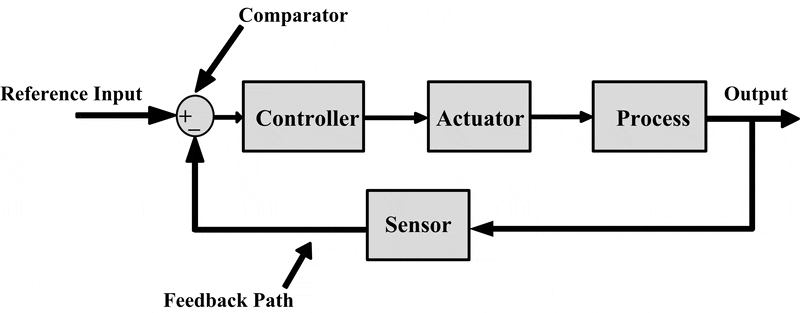

This is the main disadvantage I see about using modern control instead of classic control, since classic control deals with transfer functions and I could easily see where the sensor, the actuator, the plant and other signal conditioning blocks would fit:
Block diagram of a feedback control loop: reference input enters a comparator (+/-), then Controller, Actuator and Process blocks in series to Output, with a Sensor block returning the output as the feedback path.
Easily the input could be a voltage (corresponding to the angle), the controller could be a PID controller made with op-amps, the actuator could be a motor, the process is the inverted pendulum, the sensor could be a rotary encoder or a potentiometer, and the output could be the output angle. Other elements like amplifiers, filters, and so on could be put between the controller and the actuator. Also the comparator could be an electronic op-amp since the input and feedback path signals are electrical in nature.

  • Block diagram of a feedback control loop: reference input enters a comparator (+/-), then Controller, Actuator and Process blocks in series to Output, with a Sensor block returning the output as the feedback path.

MarcusAu314 said:
Where do other elements like sensors and actuators be in the block diagram?
Sensors and actuators convert one kind of signal to another. Perhaps electrical to/from mechanical. Most often, we depict them in the block diagrams as a transfer function of 1, so they don't need to appear at all. But if they have a transfer function other than one, they need to be included as in the block diagram you posted.
The controller can be anything, electrical, mechanical, pneumatic, or digital. In the modern world, digital controllers (meaning computers) are frequently used. It is up to the engineer designing the system to choose what type of controller to use based on its total advantages.
