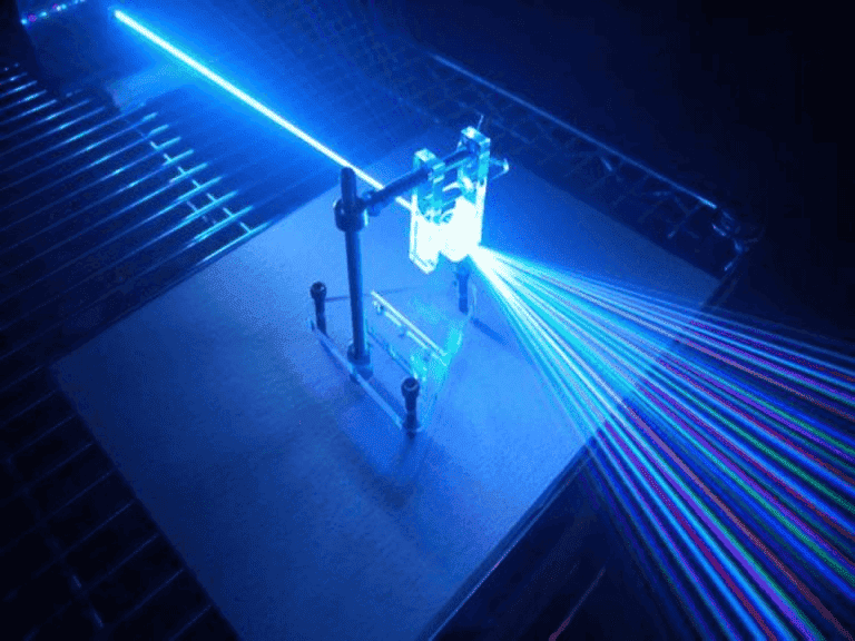

  • #32
Due to mechanical restraints, a typical lens (non-fresnel) must be used. This particular fresnel lens emulates a condenser. Part of the reason I have came here is because I can't understand why this particular lens is chosen.
The pattern is essential for the entire apparatus, without a good formed pattern the device is useless.
  • Does this somehow condense the light in a way that it forms the pattern faster?
    • How?
  • The formation of this 'good' pattern, is directly tied to the focal length. The image plane being here produces this beam pattern, and no where else is really even close to correct.

See that is the thing, for experimental research I used a laser that uses an optical element that splits the laser into a dot matrix. The dot matrix was 4" wide and tall after passing through the fresnel lens. Both at 2" and 20" from the fresnel lens, the matrix was still 4" in size.
This becomes no longer true if the image plane is no longer at the focal length.
This begs the question: Why does the dot matrix not change size with a change in distance to the fresnel lens? (when the image plane is at a focal length distance away from the fresnel lens)
Perhaps the laser's light was still collimated after passing through the splitter. That would make the source act like it's at infinity, regardless of the actual distance from the lens. This would explain why the image remains the same even though the source is moved and also why the image plane is located exactly at the focal length of the lens. This only happens when the source is 'at infinity' or the light entering the lens is collimated.
Here is my two cents worth.
The dot pattern was produced by the laser using a very small on axis 2D square grating (holographic). This is not uncommon. Because this is at the focus of the lens, it creates the pattern which is projected to infinity as described.

The pattern from such a holograph is very sharp lines of nodes (diffracted) forward in an expanding square grid pattern from the laser spot. These then behave exactly like the "rays" in a ray trace which is I believe is what is being seen...just geometrical optics from there on so they become parallel by the lens. (?)

tud623 said:
It is a laser with another lens that press fits onto it, where this optical element creates a pattern (maybe this is a hologram by definition?)
You really are drip-feeding us information aren't you? I know what you mean now. The "lens' you describe is not a lens; it's a hologram. I have a laser with a range of 'filters' you can put on it and project a range of holographic patterns on the wall. I would definitely class those filters as holograms. The image distance is wherever the wall happens to be. Where does this all fit into the diagram you posted?
If it really is like you say, then the position of the light source is, indeed, at -∞ and, no surprise, it appears bang in the focal plane of your fresnel (1/f = 1/v + 1/∞) and takes the form of your grid pattern. That's what you saw. Like I was saying to @hutchphd , introducing the holograph from the start is adding far too much complexity.

If you look at a laser beam it doesn't spread out as if from a point at the end of the laser. The beam will be parallel (as we know) and not a wide cone, which it would be from a point on the exit.
Laser beam through diffraction grating:
Do you now understand what I am talking about? I am happy to discuss.
  • #54
I'm happy too; it is sorting out my mind usefully.
Yes. We both see the same thing but I think your interpretation is 'not right' or perhaps 'limited'. Looking closer, you can see that there is dispersion which forms, say four separate orders (just looking at a single colour).
Imagine that the grating (representing what the OP has) behind a screen so that all you can examine is those beams. They all emanate from, apparently, a single location - the grating. However, a close up of one beam will show a beam with parallel sides (same angle all the way along - ignore the diffraction due to the limited aperture). If you had to use that beam to estimate where the source is, you would say that it's at 'infinity'. So you would have conflicting observations; beams spreading out from a nearby 'point' but single beams with apparent sources at infinity. You are seeing one thing and I am seeing another.
Now replace the grating with a box with a halogen bulb plus simple filter and an array of holes in it and look at one of those mimic beams. The beam will be diverging as if from a source that's inside the box; that's conventional non-coherent optics. You could definitely say that the source is a point. No conflict here and we will both interpret it in the same (conventional) way.
If you use a convergent lens on both of those bundles of light, you will get different results. The individual split laser beams will form sharp spots at F and there will be a scaled image, consisting of defocussed spots, formed in the plane at v according to the f and the u.
