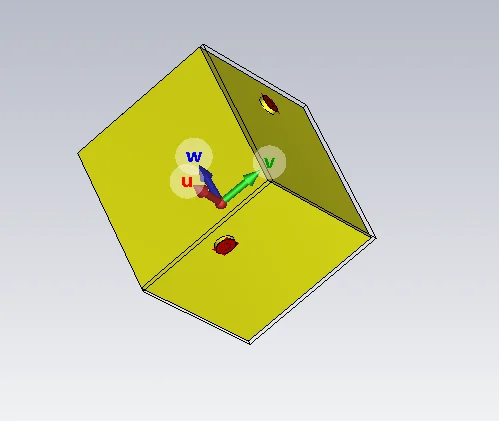

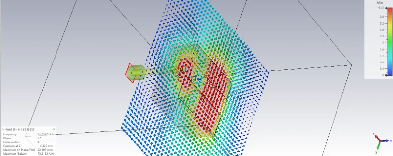

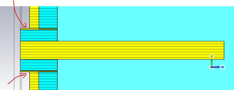

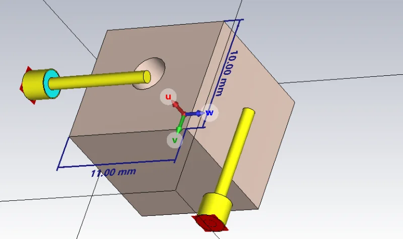

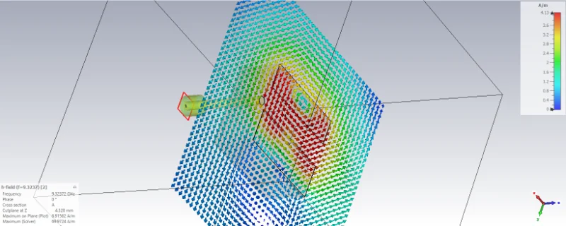

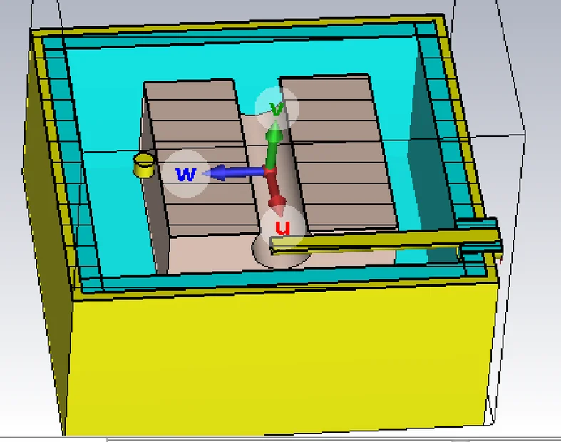

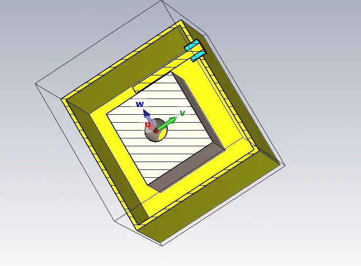

Hello , I have built a resonator as described in the photos and the link in the video below.
Basickly each coax cable excites a mode in the dielectric saphire cube shown below.
However I need to confine the whole system in a metal box where both exitation connector so outer coax coating connected to the box as shown in the end .
As I do that I get a tottaly different resonance map I get many many spike of resonanse in stead of the original.
I Know that the metal box add lots of capacitance . Is the a way to minimize the effect of the metal box so the resonance will be as if the is no metal box?
Thanks.

I suspect your problem is more of a wave guide problem than capacitance.
With a 3cm wavelength, your "ground" level will criss-cross the surfaces of the box every which way.
I would use dual-coax, ground the outer layer to the box and use the inner layer and the core for your resonator.

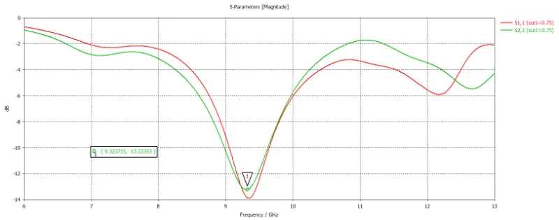

I connected the box to the outer coating of the coax cables as shown below.
Also I put an absorber that made the situation much better.
However as you could see my mode is only -10dB.
what do you reccomend for improving coupling?
Thanks.

You must learn to think about conductive surfaces differently.
At 8 GHz the chassis or external ground connection, between enclosure and generator, will for every half wavelength, cycle once around the Smith Chart, from zero to infinite impedance.
The inside and outside surfaces of the enclosure, are well separated by the skin effect depth in the conductive material. The only place where inside is the same as the outside, is where a poorly connected screen of a coaxial connector, communicates between the two surfaces, appearing like a lossy slot antenna, or a coupling orifice.
An RF absorbent wall will spoil the Q of the resonator, by robbing it of valuable circulating energy. A perfect conductor would make a perfect reflector, so energy that reaches the enclosure wall must be arranged to return to the resonator, with constructive interference.
Look at the conductive enclosure as having mirrors on the inside surface that reflect the image of the resonator. The resonator will see its EM image repeated to infinity in the three dimensions and six directions. Now space the wall mirrors from the transducer to bring the 3D lattice of virtual resonators into phase, and you will see a very significant improvement in the Q of the resonator.
If you design a resonator to have a metallised external surface, then the enclosure will not be needed, and any enclosure dimensions will not be critical. The analysis of the surface conductor, should be as two isolated surfaces, the inside and the outside. At 8 GHz, those surfaces are isolated almost perfectly, by skin effect in the metallisation.
Hello , I am having trouble to visualise your words.so basickally you say to replace the connector instead of adding an absorber ,Could you please reccomend me a connector to use.
What kind of excitation connector has isolating third layer?
in the photo below I have regular SMA which has two layers(signal and ground)
Where is exactly the parasitic slot antenna could you draw it on the photos I posted so I'll know the source of the problem?
Thanks.

SMA is suitable so long as it is in close contact to the conductive enclosure, without gaps that could act as short slot antennas.
The problem you have is not radiation from a slot, so much as absorption of the resonant energy inside the enclosure.
A coaxial cable transmission line, and its connector, have three conductive layers. There is the outside of the inner conductor, with an equal and opposite current flowing on the inside of the outer conductor. Then there is also the outside of the outer conductor, which is independent of the internal transmission line, and functions like an external antenna, against the rest of the universe.
If the enclosure is a single conductive sheet, then you need to solder all around the outside of the coax as it passes through a hole in the enclosure wall. The stray external current on the coax, will then flow over the outside of the enclosure. The stub of coax inside the enclosure will then be connected only to the inside of the coax and enclosure. The length of coax outer conductor, inside the enclosure, will make a tuning stub. The inner conductor will excite the resonator, through magnetic or electric coupling.
The important thing is to place the enclosure walls at a distance from the resonator, such that the wall reflects energy back to the resonator, in phase. My guess would be that the enclosure wall should be λ/4 from the resonator, so the enclosure box would internally be, a λ/2 cube at the resonant frequency.
