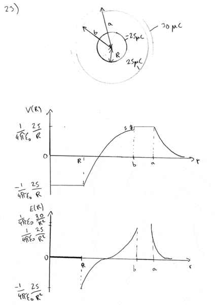

A metal sphere of radius R with a charge q is surrounded by a concentric metal sphere as shown in Figure P.23. The outer surface of the spherical shell has a charge of + 30.0 μC and the inner surface of the shell has a charge of +25.0 μC.
b is the radius of the inner surface of the shell and a is the radius of the outer surface of the shell.
(a) Find q
q = -25.0 μC, since a conductor has no electric field. Only the charge on the inner surface of the outer shell affects the metal sphere inside.
(b) Sketch qualitative graphs of (i) the radial electric field component Er and (ii) the electric potential V as functions of r.

I uploaded my graphs, but I’m not sure if people are able to see my attachments.

Let’s start with V(R)
For r < R (inside sphere), V(r) = -25.0 μC/(4ΠΕ0 R)
The potential is constant and equal to the potential on the surface of the sphere.
For R < r < b, the potential goes from -25.0 μC/(4ΠΕ0 R) to + 25.0 μC/(4ΠΕ0 R).
For b < r < a, the potential difference is constant. V(r) = 30.0 μC - 25.0 μC = 5 μC.
For a < r, the potential difference follows a curve from 30 μC/(4ΠΕ0 R) to 0 as r nears infinity.
E(R)
For r < R (inside sphere), E(r) = 0
The electric field within a conductor is always 0.
For R < r < b, the electric field goes from -25.0 μC/(4ΠΕ0 R^2) to + 25.0 μC/(4ΠΕ0 R^2).
For b < r < a, E(r) = 0
For a < r, the electric field follows a curve from 30 μC/(4ΠΕ0 R^2) to 0 as r nears infinity.
It is easier to follow on the attached graph but I'm still not sure if people can see my attachments.

Correct q. I suggest a different wording. It sounds like you are saying that the charge on the inner surface of the shell is causing the charge to appear on the inner sphere. In fact, it is the other way around. A charge placed on the inner sphere is what causes the charge to distribute on the inner surface of the conducting shell. Without the charge on the inner sphere, there is no way you can get any charge to stay on the inner surface of the shell.
This is not correct. The potential is constant, but not the value you state.
This is not correct. The potential does change in this region, but not the way you say. What is the equation that describes the changing potential?
The potential is constant in this region, but charge is not potential. Reserve the phrase "potential difference" for talking about the difference in potential between two points. By convention, we choose to define the potential due to any configuration of charges to be zero at infinity, and talk about the absolute potential at other points. It is correct to say the potential difference between any two points in this region is zero, or to say the potential in this region is constant.
This is not correct. You have used to wrong radius. What is the equation of the curve?
I think you understand that for one spherical surface with a uniform distribution of charge the potential is inversely proportional to the distance from the center at points outside the sphere and constant inside the sphere. I suggest you start in the r > a region and work inwards, keeping in mind that each surface makes a constant contribution to the potential inside of that surface. Any variation in potential in a region is the result of the net charge closer to the center of the spheres.
cyberstudent said:
E(R)
This is correct.
This is not correct. The outer shell contributes nothing to the electric field inside its cavity. What is the equation that describes the electric field in this region?
This is correct.
This is not correct. You have used the wrong radius. What is the equation that describes the electric field in this region?
I still cannot see them, but I know what they are supposed to look like.
