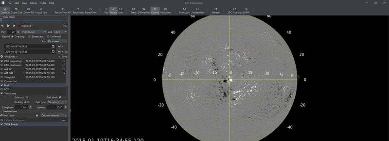

So I understand that the Earth is north of the Sun's equatorial plane in around September to March. So a geostationary satellite observing the Sun would seem more of the Sun's northern Hemisphere than its southern. But, using jHelioViewer to show the Sun with its equator marked on as a Stonyhurst grid shows more of the southern Hemisphere than northern. Can anyone shed any light on this?

Perhaps the 23.5 degree tilt of the Earth's axis?

No. The satellite that takes the images is in geostationary orbit and looks straight at the Sun, the tilt of the Earth's axis is irrelevant.
Great. I thought I'd look into this, and now I'm confused too.
Let me rephrase the issue.
The software shows the solar equator as seen from below between early December and early June, and from above the other half of the year. The maximum displacement angle corresponds to the ~7 deg axial tilt of the Sun w/r to the ecliptic. That this is correct is acknowledged e.g. here: https://solar-center.stanford.edu/solar-images/latlong.html
This implies that the axis of rotation is tilted roughly in the direction to the vernal equinox, since about two weeks earlier in March the solar equator is maximally displaced upwards.
Now, sources (e.g. https://link.springer.com/article/10.1007/s10569-007-9072-y) list the direction of the solar north pole in celestial coordinates as ~286 deg RA, ~64 deg dec. I.e. roughly in the opposite direction than the axial tilt of the Earth (w/r to the ecliptic). Which should make the equator visible from below from September to March (opposite to what @Arbu wrote in the OP, I think).
So there's like ~60-90 (?) degrees/quarter of a year shift between what my reading of the coordinates suggests and what happens in reality. Where's the mistake?

A search for "stonyhurst grid" easily yielded this reputable source:
https://solar-center.stanford.edu/solar-images/latlong.html said:
Earth crosses the Sun's equator about December 7 and June 7 each year.
...which was already a part of the discussion.
