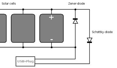

I'm working on a project where I charge a 12 volt battery with a 12 volt solar panel. Links for the battery and solar panels are below. My question is how I should connect the two. The main thing I can find is that I don't want the solar panel draining the battery. I plan to put a diode from the positive terminal of the solar panel to the positive terminal of the battery. My first specific question is should I use a 1N001 diode or a 1N5820 diode or something else? The only problematic difference I see is the average rectified output current limit. For the 1N001 it seems to be 1 amp and for the 1N5820 it is 3 amps. The max output on the solar panel is 1.78 amps.
My second specific question is, should I be doing more? I have found several more complex circuits but I don't understand their advantages for my purposes. If I can do something to increase efficiency I would like to try. An example is directly below.

I've looked at your links, and you can hook them directly together with no intermediate circuitry. This does though require that you continuously monitor battery voltage such that you never exceed 14.4 volts.

Hi jabers
the initial description of the charger circuit tells you about the diode and how they replaced it
the first 2 listed features are also really important.
in that you cannot just continue to "pump' power into the battery from the solar panel
as you will just cook the battery and kill it
was there anything else in the first 2 sections in that charger link you are unsure of ?

It sounds like your system will work. Unfortunately, my electronics is very rusty, and I can't help you with this circuit. My circuit would be very rudimentary, almost Neanderthal in comparison. If I were not concerned with panel degradation, I would simply hook up a 14.1 volt zener diode:
The USB thingy being replaced with your 12v battery.
