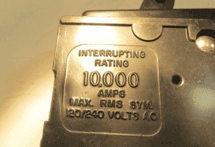

All protective devices have an "interrupting rating"
beyond which the arcing is just too intense for it to quench.
Look at the household breakers in your panel or on a hardware store shelf.
You'll see a number probably 10,000A "sym" meaning symmetrical, ie not DC..
Here's a 30 amp beaker...
240905
If you expect that breaker to protect anything
don't put it in a panel fed by a transformer that's capable of more than 10,000 short circuit amps.
Copper vapor follows the same gas law as dynamite vapor.
Just something to be aware of in your travels.

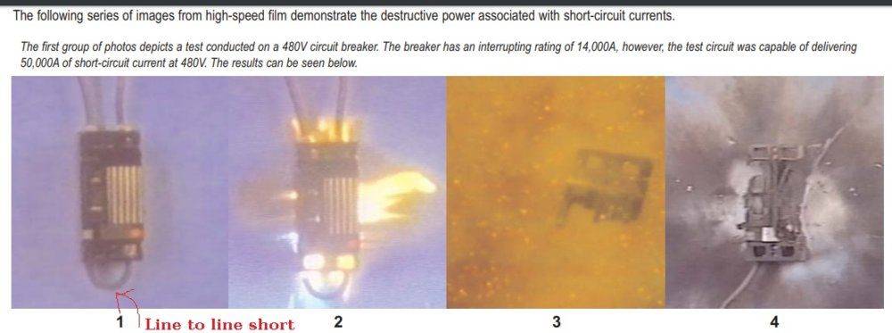

more here
http://www.cooperindustries.com/content/dam/public/bussmann/Electrical/Resources/solution-center/technical_library/BUS_Ele_Tech_Lib_Interrupting_Rating.pdf
Four high-speed film frames of a circuit breaker during a short-circuit test: frame 1 intact, frame 2 with a bright arc flash, frame 3 a dark blurred shape amid glowing debris, frame 4 a damaged breaker with a burst pattern on the wall behind it. Labelled 1 to 4, with a note reading Line to line short.
blew the case apart and charred the wall...
I have it on authority that some in the industry abhor the phrase "blow the case up" or the like in reference to fuses, breakers, ect. The proper palliative to use is to say that these devices "rapidly disassemble".
