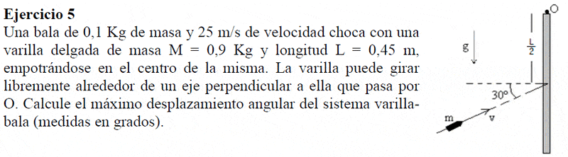

Hi. Just look at the picture, I will explain it:
It says that a bullet impacts the rod as you can see (in the center of mass forming a 30 degree angle with the horizontal and keeps inside the rod) with a speed of: 25m/s. The bullet has a mass 0.1Kg, the rod 0.9Kg and the length of the rod is 0.45m.
I'm asked to find the maximum angular displacement that has the rod respect to the vertical. (the bullet keeps in the rod).
What I did first was to realize that the angular momentum is conserved just when the bullet impacts the rod, after that what is conserved is the energy so I wrote:

But now, how can I get the angle? The correct answer is 79,5 degrees.

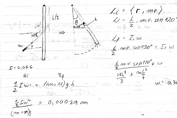

Draw a diagram with the rod at an angle. Label h on the diagram. (Actually, it might be more intuitive to label 2h; that's what I did anyway.) Also label L with the rod in its original position, and in its final position. You should have a right triangle now. You can use that right triangle to solve for the angle (the maximum angular displacement) in terms of h and L.

Alright, yes, the diagram is the first thing I do always. I have that triangle but I don't understand why you say 2h when it's actually 1h. I think you are taking 2h from the floor, arent you? Anyway, I cannot realize how to find out the angular displacement just having h- Thank you!
** h is the height the center of mass displaced. I am not taking it from the floor
This is what I have:

Okay, we'll try it a different way. Label L/2 on the diagram in two places: One at the rod's original position, and again when the rod is at maximum angular displacement (L/2 is at an angle at the latter position). Now label h on the y-axis.
You should see a right triangle now with hypotenuse of L/2. You should now be able to determine what the adjacent side of the triangle is in terms of L/2 and h.

Rather than label h somewhere off in the middle, label h on the y-axis, with the "bottom" of h at L/2. Then connect a straight line between the top of h and the point at where the rod's L/2 is at its final position.

Wait, the right triangle you say is the one which is connected by O (point of rotation) initial L/2 and final L/2? Now I see two right angles. The one I told you and the other which is formed by connecting O, L/2-h initial and L/2 final
There may be more than one similar triangle, if one works at it. :smile:
But you've found at least one triangle that's good enough. In one triangle (where the angle in question is at the point O), the adjacent side is (L/2 - h) and the hypotenuse is L/2. With that, you should be able to solve for the maximum angular displacement (i.e. the angle up at O).
