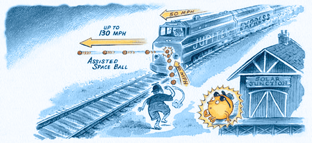

Another way to describe an elastic collison is one where the separation speed between the two objects is the same before and after the collision. That implies that the KE of each object is conserved in the frame of the other.
A common analogy is throwing a ball against a wall that is approaching you:
https://solarsystem.nasa.gov/basics/primer/
This is also similar to making an effieicent U-turn with a plane in a moving airmass:
