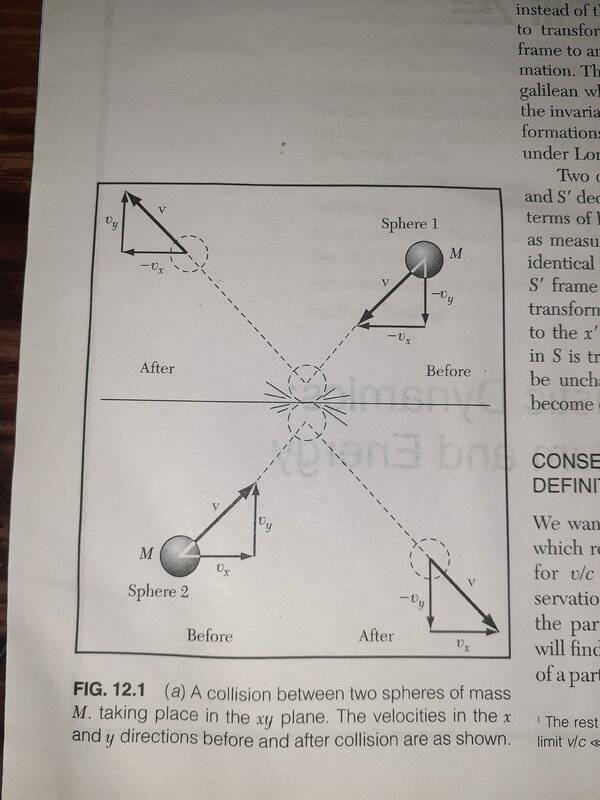

Given a collision, I have to verify that the y component of the collision remains the same in the given reference frames(photos are attached) which differ only by x components of velocity(berkeley physics course pg 375)
