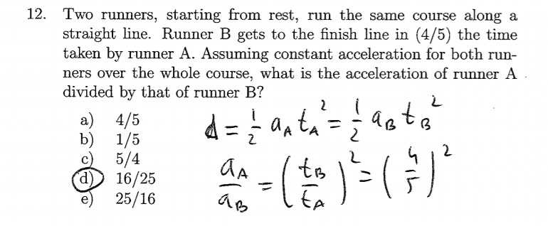

Handwritten solution to a constant-acceleration problem: d = (1/2) aA tA^2 = (1/2) aB tB^2, giving aA/aB = (tB/tA)^2 = (4/5)^2, with multiple-choice options a) 4/5, b) 1/5, c) 5/4, d) 16/25 circled, e) 25/16.
d = vit + 1/2at^2
Hey, so what i did was different from the answer key above. Instead of (4/5)^2 i did 1/ (4/5^2) so i got 25/16 as the answer. I'm not sure why tb/ta = 4/5 since 4/5 the time is referring to runner b's time? Why is it combined here?[/B]

Runner B is gets to the finish line first. You are asked for the ratio of runner A's acceleration to that of runner B. Which one accelerated faster?

Runner b because both runners ran at constant acceleration

nvmd, i was able to get the answer. I had to solve for a for both runners and plug in time, and then put them in ratio
The slow guy took ##T## time. The better one did the same distance ##x## in ##0.8T##. You correctly observed that in this instance, ##x=\frac{1}{2}at^2##. We have two equivalent ##x##'s since they ran the same distance. Let's carefully label our accelerations, ##a_1## for the slow guy and ##a_2## for the fast one. Now
$$\frac{1}{2}a_1 T^2=\frac{1}{2} a_2 (0.8T)^2$$
Which easily simplifies to ##a_1=0.64a_2##. Since we want ##\frac{a_1}{a_2}##, we can just rearrange and find that ##\frac{a_1}{a_2}=0.64=16/25##.
