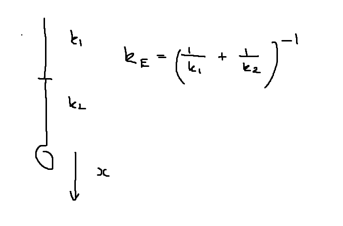

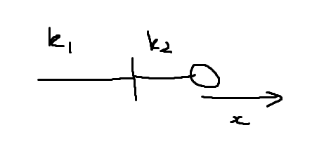

I would be happy doing that if the spring was extended from either the left or the right. However the spring is clearly being extended in the middle (hence one spring is being compressed and one extended).
If it looked like this then I would be fine.
Hand-drawn diagram of two springs in series: spring constant k1 on the left of a fixed wall-like tick mark, spring constant k2 on the right, attached to a small circle (block) with an arrow labelled x pointing right.
  • Handwritten sketch of two springs in series hanging vertically, labelled k1 above and k2 below a point, with a downward arrow labelled x at the lower end. Beside it is the formula kE = (1/k1 + 1/k2)^-1.
Again: The springs are not in series. The mass is in between the springs
Ok. I have done some googling and found out that the effective spring constant is the sum of the individual ones rather than the harmonic thing I was doing before. This however does not indicate that they are in parallel, right? Is there an intuitive reason as to why the constants add.

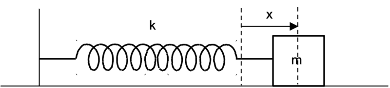

You are missing the point. The spring constant that you calculated is that of the combination, i.e. of an equivalent spring. In other words, replace the two springs with a single spring that has the spring constant that you calculated and such that the given mass oscillates with the given frequency.
It looks like this
Diagram of a mass m on a horizontal surface attached to a wall-anchored spring labeled k, with a displacement arrow x measured from the equilibrium position indicated by a dashed line.
sdfsfasdfasf said:
So the mass need not be in the middle anymore?
Not if you consider the equivalent situation.
They are very much in parallel. Consider what would be the difference in terms of forces and energy if you changed the side one of the springs is on.
Also consider what @kuruman is saying: You do not need to consider anything as a combination of springs because you have the effective spring constant of the system as a whole. You can just use that.

I agree. It would be instructive to OP to derive equivalent parallel and series spring combinations from Newton's second law.
How was I meant to know that if we have the effective spring constant that the mass is at the end
This is the definition of the effective spring constant. It is the constant k of a spring to which the mass is attached to one end such that the force on the mass is given by F = -kx where x is the displacement.
"effective" means you don't have to worry about why the spring constant of the combination has that value, it just does.
As regards "parallel" versus "series" in the context of springs, the real distinction is whether a displacement x of the load implies a length change of x in all the springs (parallel) or is shared somehow amongst the springs (series). Or, in terms of forces, whether the net force F on the load implies that force on all the springs (series) or is distributed across them (parallel). Note the reversal.
In the arrangement given here, both views would classify them as parallel.
