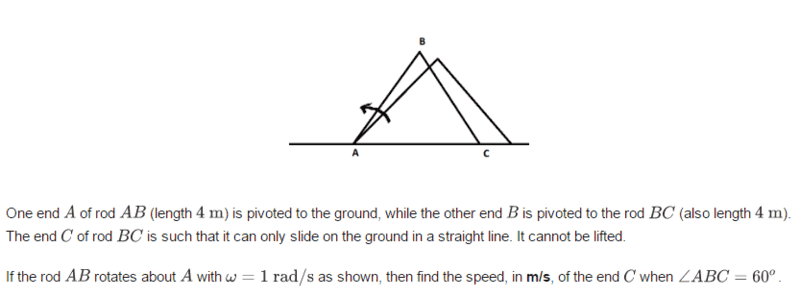

Constrained Motion of a Pair of Rods
9 replies · 2K views
Viraam
66
## v = r \omega##
Velocity of point B= ##v_B = 4 \times \omega = 4 ## m/s
Since the separation between B and C is constrained to be a constant, Velocity of B along rod = Velocity of C along the rod
## \Rightarrow v_B \cos \theta = v_C \cos \theta ##
## v_B = v_C = 4 ##m/s
However the answer provided is ## v_C = 4 \sqrt 3 ## m/s. Where did I go wrong?

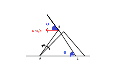

Please define which angle you are denoting by ##\theta##.
Do the velocities of points B and C make the same angle with respect to rod BC?
Oops... Forgot to mention that. Sorry.
OK. But your red vector is not in the correct direction to represent the velocity of B.

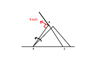

Ohh I get it. I took the wrong vector. Isn't the red vector supposed to be tangential to AB?
##\vec {v}_ {_B}## is not tangential to rod AB. Rod AB is rotating about A.
What is meant to ask is if the vector ##
\vec {v}_ {_B}## at an angle of ## 90^ \circ## to AB? Like in the figure here.
Yes. We would say the velocity is perpendicular to rod AB.
Thanks. I got the right answer now. The angle between the velocity vector and the rod is ##30^\circ##.
## v_B \cos 30^\circ = v_C \cos 60^\circ##
## v_C = 4 \sqrt3##
Looks good.
